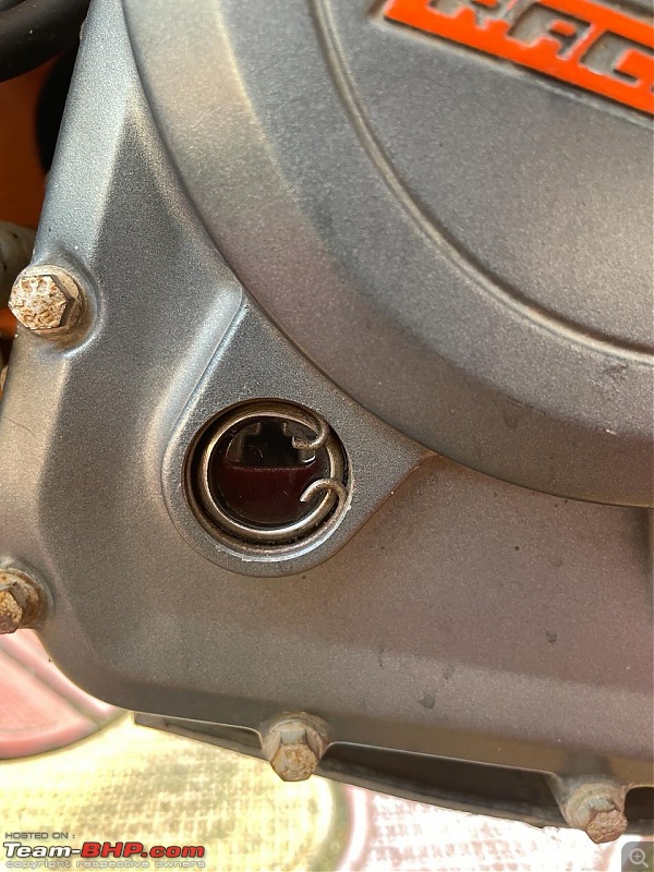

The manual says to check the oil temperature once the bike has reached the operating temperature. Now which temperature bar is that ? I'm keeping close tab on the oil level, as this is a used bike.
So far I've checked the engine oil at temperature bars four and eight, after riding for some time and checking it at intervals of 1 min, 5 min and 10 min. The oil level is near the max line till the first 5 minutes, but what I've noticed is that as time passes and the engine starts to cool down, the level starts dropping. This makes me wonder if I'm low on oil
Once the engine is ice cold, no oil can be seen. Where does the oil settle down once it's cools down? My previous bike a 150cc commuter showed oil level even when cold, so this is a new experience for me.
shadowrider is offline

Re: The KTM Duke 390 Ownership Experience Thread
The engine casing should be warm to hot to the touch. Which means you should be able to put your hands on it to check.
Cheers, Doc
Hal temperature bar on the dash is a good indicator.
Engine oil level reducing when its cold is normal and nothing to worry about. Just check levels when engine is warm and i its close to max, all good.

This is the oil level after a 5-minute warm up with temp bar around 5 ( which is half) and 10-12 minutes cool down.
Once your engine is at operating temperature, the oil gets thinner and much more fluid, and it therefore does not need a cool off period of 10-12 minutes to drain back from all the lines and channels and give a correct read. In fact 10-12 minutes is excessive, and will likely give an incorrect read. 1 minute is what is recommended.
This is how the sight glass looks when the engine is ice cold. Absolutely no engine oil to be seen.
Is this normal that no oil is seen even when the bike is leveled on a cold engine?
The warmed up sight glass oil level reading on your motorcycle is perfectly per spec, right in between the maximum and minimum. Now, why you don't see the cold oil level is simple. When your bike is on side stand (side stand on the left) the bike tilts to the left, the entire engine oil from the sump is transferred to the left of the bike's innards where gearbox is situated. Oil will flow back into these tight galleys and once cold they will take a longer time to show the reading.
PRO TIP! Your engine oil grade is what determines the viscosity of your oil. i.e. how well the oil flows. Thinner a grade, faster the oil flow, thicker the grade slower the oil flow. Remember you made a point why your 150 cc showed quicker oil levels? Now you know why.
A 15w50 will flow slower than a 10w30 would. Hence you read ZERO oil level when the bike is stone-cold. Why? Because of all the above reasons combined, the bike on side stand, oil creeps its way to the left of the engine when left overnight, thicker engine oil means the oil has to overcome all the entry points, shifters, cogs, oil galleys, bearings etc, and then to the right side of the bike finally to your oil sight glass. It's a tough life isn't it!
Stop sweating over it, your bike's oil level is perfectly fine.
