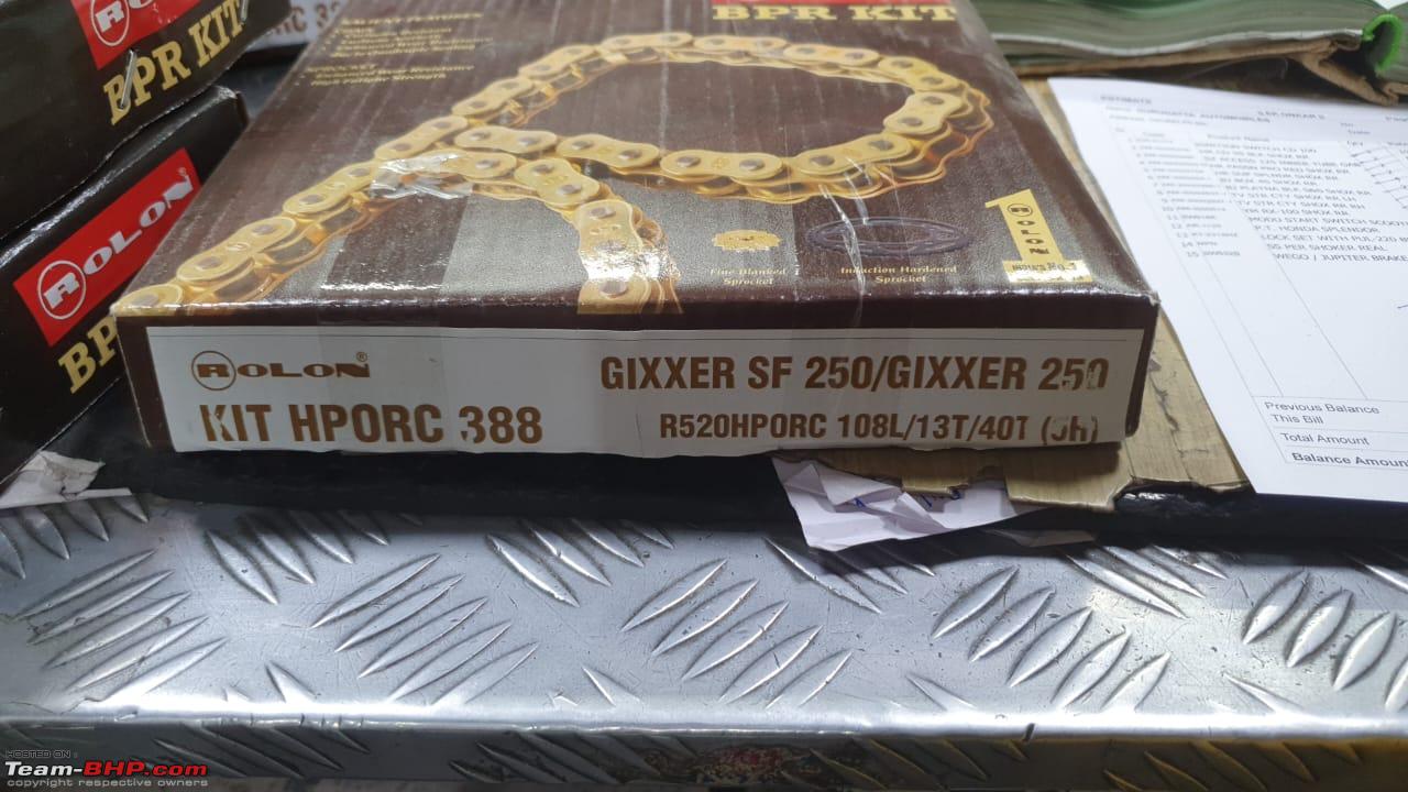

The Rolon dealer, Mr. Taran Singh Kandhari, so kindly just hand delivered these kits to me at home. A big thank you to Mr. Nesan from Rolon, my longtime Bullet racing days OE sponsor, for making the Gixxer kit available. The Duke 390 kits are freely available at most dealers. Not so the Gixxer ones, that have just been launched and perpetually out of stock.
Fresh from the discussion on the fallibility (and attendant risks) of chain locks for high rpm, high torque applications, I asked him to first confirm whether both chains wete one piece rivet chains.
He confirmed that the KTM Duke 390 definitely was, but that the Gixxer 250 SF chain was a lock type chain. My heart sank, and I told him then that I was definitely not interested in picking that one up. So I asked him how about the regular Rolon chain for the Gixxer. He checked online and confirmed that the regular chain in fact was a single piece riveted chain without lock (those come with a -02 code, while the lock type chains come with a -01).
He seemed surprised that the cheaper regular chain was riveted and the costlier brass chain (with induction hardened sprocket, etc.) was not. Then he said, let me open the packing and check the chain physically (which is what I assumed he had). And lo and behold, the chain was a single piece riveted chain (photo below of the actual unpacked chain)! Huge sigh of relief!
Duke 390 chain without lock.
Gixxer 250 SF chain with lock (per the system photo and specs and code).
Ordinary Gixxer 250 SF chain without lock.
Actual unpacked chain of the Gixxer 250 FF kit, without lock. Single piece, riveted.
The Gixxer 250 SF chain is an O ring chain while the Duke 390 chain is an X ring chain. The Duke 390 kit also mentions (different to the Gixxer kit) a rubberized sprocket for the front sprocket. Both kits have induction hardened sprockets at the rear.
