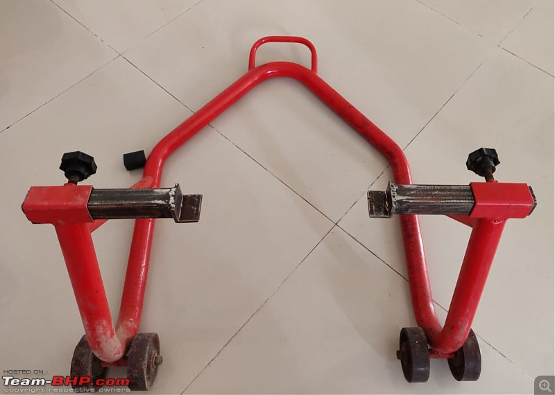

Now as stated earlier, for a hassle free chain maintenance you would need to put the bike on a center stand, a roller, or a paddock. I neither had the center stand not the roller. I had a custom made paddock for the Benelli. But sadly it was a little too wide for the CBR. As it was designed for bike with spoolers, CBR did not have any spooler neither does it have any provision for them.

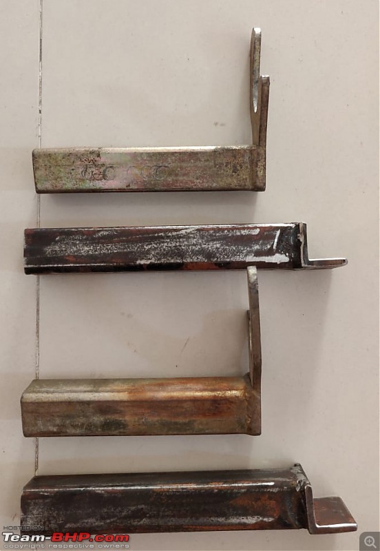

So I had to manipulate the existing paddock. The existing rods in the paddock were smaller by almost 1/2 inch to fit the CBR comfortably.
Existing Paddock and the rods to where the spoolers fit. The above image is the one where the lifting rods have been reversed to try and fit them on the CBR.
But they fell short by just an inch.
So, I got 2 new rods of the same width fabricated and fit a 'L' shaped plate at the end. The CBR's swing arm can sit comfortably on the L shaped plate.
The new rods were longer by an inch each so as to accommodate the shorter width of the CBR. They costed me Rs 300/-
