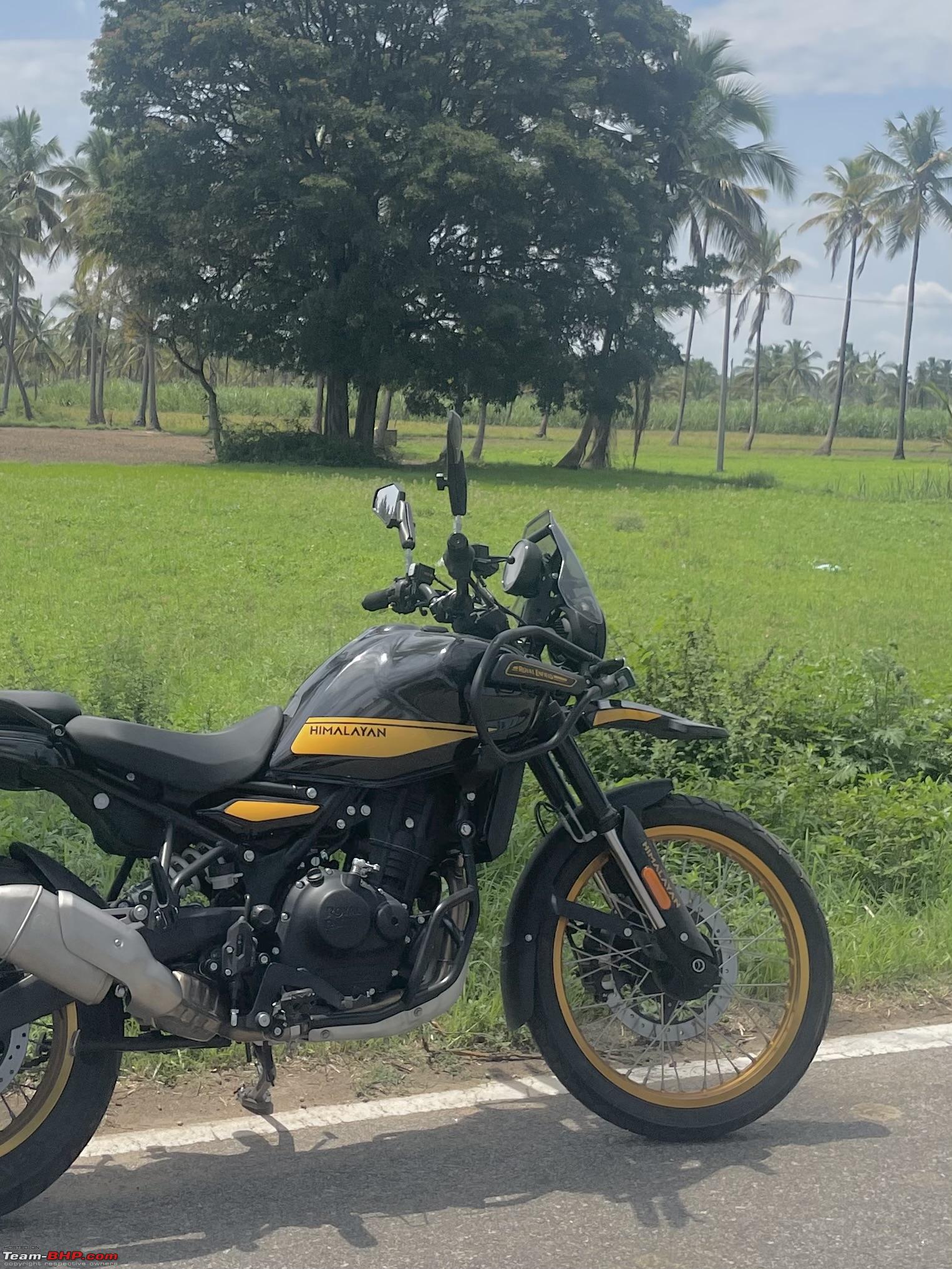

This time, the Himalayan crash guards are really good, (and secure). Took an hour to just bolt these up!
Owners should resist installing other brands, when (clearly) not endorsed by RE. My two bit!

Not much information. This was shared in a whatsapp grp run by my dealer. At least this dealer is openly communicating about this, in whatsapp grp, full of 450 owners.
As per my dealer, it is concluded that both are due to the stress caused by the after market crash guard. And dealer asking owners to remove them and go OE.

On one hand, good on the dealer for being transparent and communicating with the customers well.
But on the other hand. You're telling me that if you put a crash guard on a Himalayan, it could cause the chassis to break and the engine to fall out? I'm no engineer or anything, but.... doesn't that strongly imply the bike's design wasn't well thought-out? I've never heard of this happening on any other bike model. Why is the Himalayan so special?

Seems like people are quick to jump on the RE bashing band wagon and not considering that our after market accessories are worst than Chinese plastics with lead paint.
In the cases shared here, the criticality of a bolt to which the engine is mounted is underplayed. If it was loose, either due to badly designed 3rd party accessories or due to non proper torque on the bolt while making the install, it will be a critical issue.
I have seen this on Interceptor 650 where a badly designed leg guard (3rd party, you know the popular one) results in damage of the crankcase requiring the replacement of the whole crankcase.
I believe the owners are responsible here when they trust the 3rd party accessories and the road side mechanics to do the job properly.
