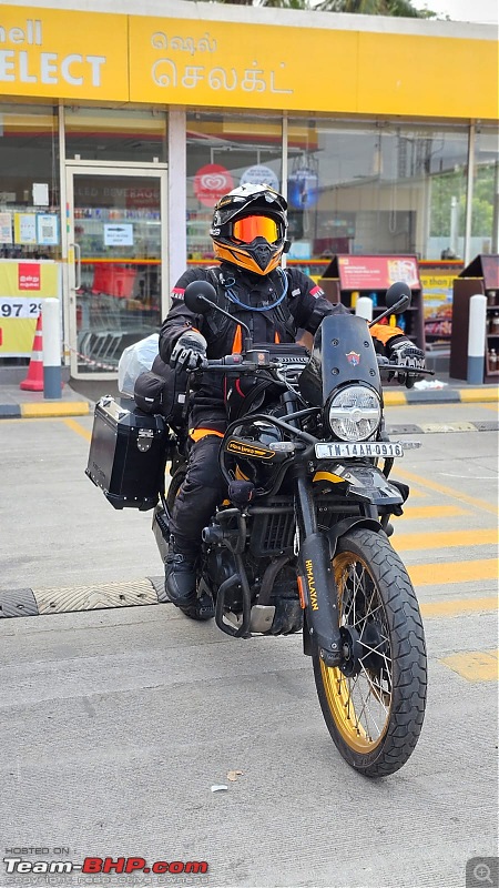

Old 6th June 2024, 06:15   #30
gkrishn's Avatar
Join Date: Aug 2004
Posts: 650
Thanked: 149 Times
re: Himalayan 450 Chassis Frame Breaking, multiple instances! After-market crash guards to blame?
Originally Posted by b16h22 View Post
The first case certainly might have something to do with a custom crash guard. The Kaza brown bike has Zana crash protection on it. But the second Hanle black bike looks pretty stock to me with no crash protection on it.
the second hanle black, apparently.
Himalayan 450 Chassis Frame Breaking, multiple instances! After-market crash guards to blame?-whatsapp-image-20240605-10.42.49-pm.jpeg
gkrishn is offline   (5) Thanks
