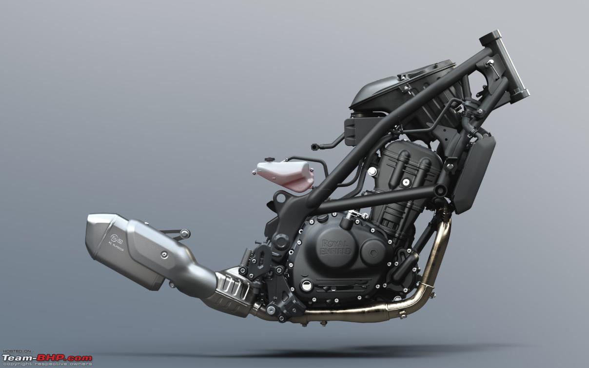

"The new Himalayan 450’s chassis uses the engine as an integral and stressed member of the frame. The Sherpa 450 engine is mounted to the tubular steel main frame at 3 points, 2 at the top on either side of the engine head and one at the bottom.
The bolts that connect the engine to frame are specialised, load-bearing units which are designed to be able to retain the correct torque specifications over a long term period. Moreover the connection between the chassis and the engine also uses a specifically designed spacer that is integral towards retaining the torque setting and correctly spreading the load from the bolt.
In both instances, when the customer installed the aftermarket protective guard, different specs of bolts were used and this likely led to incorrect torque settings."

Rather what's interesting to see, is how fragile the chassis is irrespective of the engine being a stressed member and the the investigation vindication -- simply isn't conclusive and summative at least for me.

Engine foundation bolts do not just loosen on their own. Tens of thousands of very hard run kilometres on two very raw Bullet 500s from REs own heritage stable over 23 years all over India have taught me that. Both running the original British frame that has done duty for the Indian Army for decades over the harshest terrains, in peace and war. Those frames do not break like this. And they also use the engine as a stressed member. Same metal. Same production line. Made by the same people in the same factory.
The notable difference to my non trained technically eye is that the Himalayan engine is both a stressed member front and rear ar the level of the sump casing but equally is also hanging from the top. Whereas the old Bullet engines were stressed members only front and rear, and the cylinder and head were free. There used ro be only a "head steady" bolted rod at the top. Even if that got loose, and the bolt fell off (it happened ... those bikes vibrate violently), nothing happened to the engine or the frame. Yes, you got a free massage.
Also of note, those old Bullet engines were two piece. The engine and the gearbox. Seperate. The gearbox was attached (speared) to the engine with 4 long studs, that finally joined it (both) to the frame. Not a single unit like all new RE engines, including the Himalayan. A change dating back to the UCE in 2010 (I think). And I think the old 500 engine together with its gearbox weighs in at around 48 kilos on its own. No idea about the new unit construction engines.

What if there was an added cross member, converting the engine-stressed frame into a semi-diamond one, something like the picture below. With these ADV bikes, where the rider gets (unwritten) license to subject bike to harshest of torture, it may make sense to over-engineer than to be sorry.
Aftermarket crashguard makers should also try and not fiddle with the critical points on the bike. Think of some other innovative ways of mounting the engine guard, using innovative joineries and clamps.
