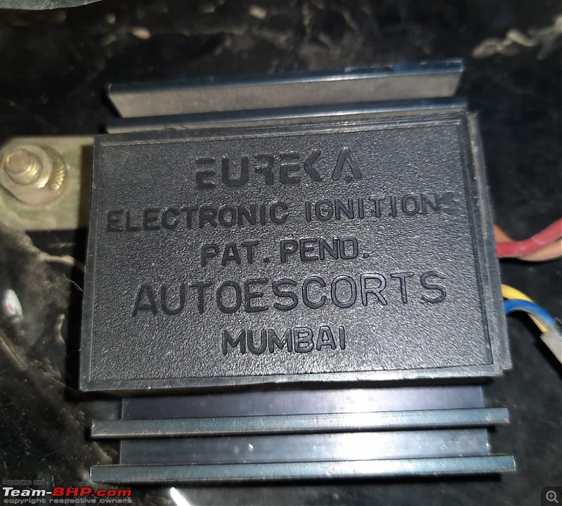

Does anyone know if the CDI unit is the same for the AVL and cast iron 350 engines?
I bought two CDI units one after the other for my 2002 Electra and both when plugged and started, kept missing. Either both the units were faulty or not compatible.
tharian is offline

Old 26th February 2020, 13:56   #3117
Twiny's Avatar
Location: Cochin-Bangalore
Posts: 322
Thanked: 63 Times
Re: Royal Enfield Queries
My CI 350 is running on retro fitted CDI for last 12+ years. Will check what type of unit it is.
Twiny is online now   (1) Thanks
Old 27th February 2020, 22:41   #3118
Twiny's Avatar
Posts: 322
Thanked: 63 Times
This is the CDI unit fitted in my standard CI 350.
Old 28th February 2020, 07:32   #3119
tharian's Avatar
Join Date: Dec 2011
Location: SBC
Posts: 4,161
Thanked: 8,644 Times
Thanks for checking.
I managed to get a CDI unit, but a non-genuine part called Swiss, which I heard are not all that great. The bike is running for now, but has some missing when I kick for the first few times.
From what I asked my mech, the CDI units are the same for both AVL and CI, so the one I got initially probably was a TCI unit,
tharian is offline
