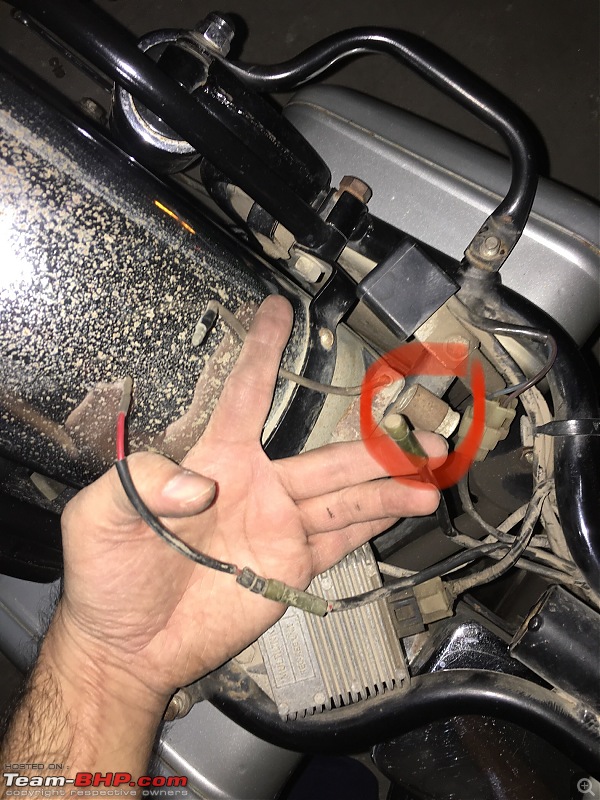

Last week, the headlight bulb fused while riding and I assumed maybe it has served its life.
Few kilometers down the road when I slowed down for traffic, it misfired with loud bangs a couple of times and stalled. Came back to life after two kicks.
I assume it is the rectifier/regulator making its way out as I also noticed the speedometer lamp going bright and dim on its own with the engine thumping steady! Or is it the earthing rusted up?
Mine is a 2002 Electra with 25,000kms.

I'm not sure what caused the engine misfire but the headlight burning out was likely due to old age.
My guess about the varying brightness of the instrument light going bright and dim is you either have a bad connection with a cable at the battery or the ground connection is bad or the battery is on it's last leg.
With a good battery and wiring connection, the variation in the output of the alternator, as the regulator adjusts the output voltage, isn't noticeable because the battery will provide the power to keep the system voltage fairly constant.
If the wiring connections to the battery are poor or the battery is failing, the variations in the alternator output will show up by the light bulbs becoming brighter and dimmer.

I figured out that the earth connection of the battery was not connected to chassis. Fixed it. Another thing i noticed is a broken connection of what looks to me like a condenser. Can anyone figure out whats the small metal canister is and whether soldering will work or not?
It does look like a capacitor to me. No idea what it is used for. Just take the whole unit (along with the wires) to a RE spare parts shop and get it replaced. Soldering may not work in such cases.

To Update on the Electricals part, found the capacitor i was looking for from and authorized spares shop costing Rs. 118.
Also got hold of a spare Regular/Rectifier from SWISS make just in case.
It is there to smoothen the flow of current from RR unit.
DC electricals are no fan of fluctuating current, drastically reduces component life, hence the Capacitor, all motorcycles have it, in some it's attached to the RR and in some it's a stand alone piece.
