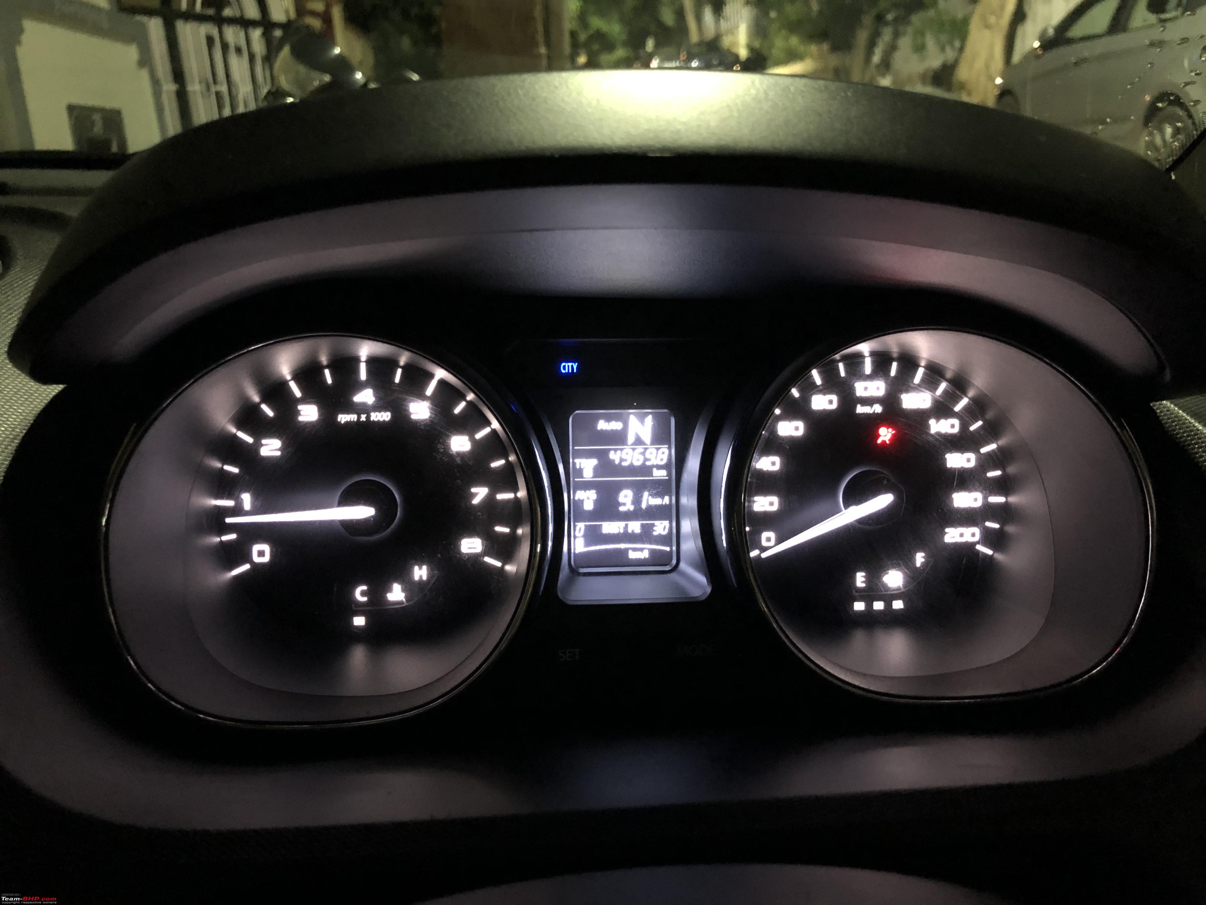

Originally Posted by Motard_Blr (Post 4575998)
The link from the audio system to the car is the BCU. Since the replacement unit also didn't work and assuming that that was ok, the BCU might be the culprit. Ask the service engineer to run a diagnostic check on that.
So finally we got the car back. Apparently they have corrected some wiring issue (which I’m very suspicious about) and it worked. They have put back the same headunit.
But now after we recieved the car,
- the airbag light stays ON
- the AC does not work (AC button doesn’t light up either).
They didn’t even check the car before they dropped it home.
This is getting really annoying. :Frustrati

From the symptoms, it does appear like it's either a control module issue (like BHP-ian Motard_Blr says), or something wrong with your wiring harness that A.S.S. is trying to fix by jugaad (potentially messing up other things as a result). Better get a diagnostic check done in your presence before anything else is tried.
Attachment 1869775
Attachment 1869776
Attachment 1869777
Sorry to hear of your troubles. I think it's time to raise a complaint with Tata motors corporate and make a big fuss about the poor service. May we know the name of the dealer/service centre?
