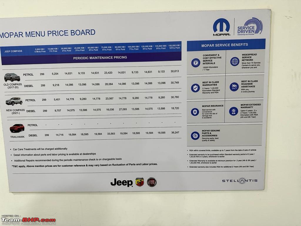

Originally Posted by theP1Fanatic View Post
My Estimate for the 3rd Service
Comparative Analysis: To highlight the absurdity of the price hike, I used a fellow BHPian 's bill from July 2023 as a reference. The discrepancy between bills from just a year apart is staggering. Our car required extra procedures for cleaning the brakes due to a squealing noise, which incurred additional charges which is understandable but the stark difference in pricing in a year is very alarming.
Link to BHPian ArjunKrish's bill for the 3rd service: https://www.team-bhp.com/sites/defau...3-09/6_15.jpeg
https://www.team-bhp.com/sites/defau...3-09/7_13.jpeg
Other than the lathe charges for skimming the rotors, which by themselves amount to 8-9k approx with GST, everything else is as expected. Skimming the rotors is not needed unless there is steering wheel shudder while braking. I guess given the steep labour, you will be better off replacing the rotors themselves, which will be of full thickness.
Also, FYI, Trailhawk always has higher service costs than standard Compass variants. Please refer attached picture for the same. Additionally for a vehicle costing 40-45 L, 20-30k annual maintenance costs seem to be the basic norm these days.
Jeep Compass : Official Review-72010fa0188544e799c4a59580656b0f.jpeg
DRIV3R is offline   (1) Thanks
