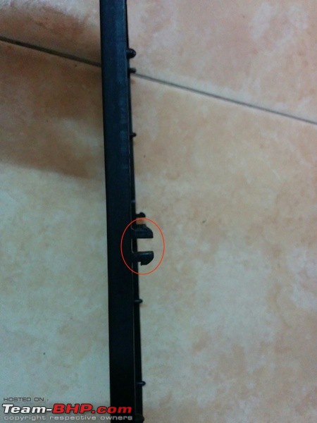

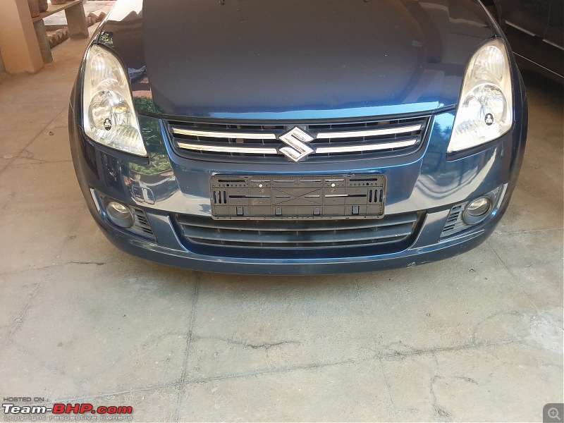

Originally Posted by vharihar View Post
If plastic, someone can just forcefully yank it away and walk away with the broken frame with the metallic plate inside it intact, isn't it?
The frame is made of plastic.
If someone intends to yank it away forcefully, he can do so but only by damaging the bottom half of the frame (That touches the car's body) which is held by the screw.
Have a look at these snaps that will give you an idea:
IND-style Number Plates : Movell, Orbiz etc.-20161021_114323.jpg
IND-style Number Plates : Movell, Orbiz etc.-20161021_113949.jpg
So if someone wants to steal this, he can do this by first prying open the outer half of the frame, pulling out the plate (intact) and then using a screw driver to remove the inner half of the frame .

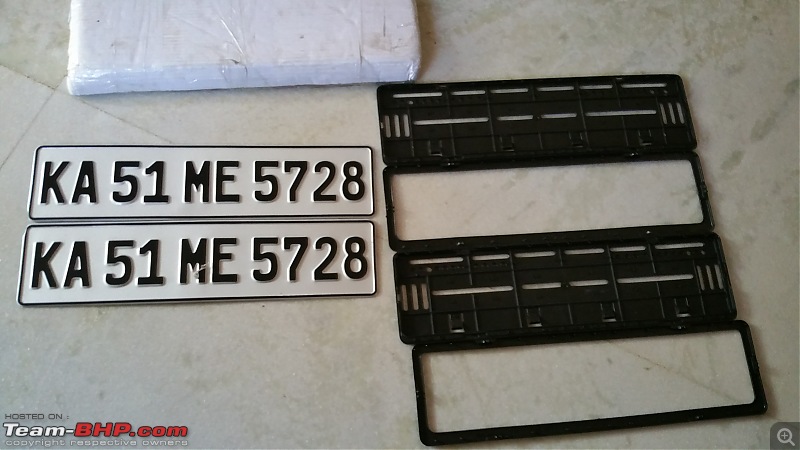

Here's my experience with the Movell License plates (got the Speedex font normal plates without "IND")...
Why ?
Dizzy® came with acrylic plates (with stickered registration number) from the dealer and was doing fine for over 10 years. Recently during a security check at a hotel, the sniffer dog's vest got entangled in the front plate and broke it in half and now I had to reason to replace the plates
What ?
Since HSRP plates aren't yet implemented in Karnataka, decided to get the non-IND type plates. Though I liked the German font ones, some numbers have a cut/break like the 0, 6, 9, etc so decided to stick to the Speedex font plates. Only grouse I have is that they could have been a tad bigger (you can see in the pics that they're not centered on the plate and tad smaller than the German font plates like the ones audioholic and paragsachania have).
Where ?
Placed the order online on Movell's website. Did not get any order confirmation email or order/shipping status but it was dispatched the very next day evening by DTDC. After couple of days I called the number on the website and was told that it was dispatched the very next day and then I started tracking the package. It took a painful 4 more days to be delivered as it went from their Central hub to the Whitefield hub and then to the outlet servicing our area.
The package from DTDC

Clips on the frame top border
There are 6 such clips. Do not try using nose pliers or such, they will break away and I was naive enough to try that first despite being warned by Viddy! Then Parag suggested using a steel ruler and I ended up with the hacksaw jugaad.
Name:  4.Clips on Frame Top.jpg

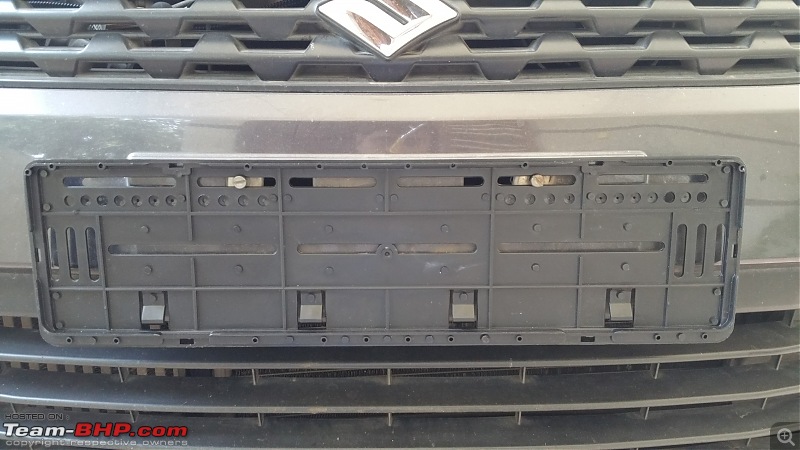

Front number plate frame base fixed
I could have used the oblong holes in the first row, but it would have lowered the plate a tad bit and the round holes were almost perfect, just one of them needed to be opened up a little for which I used the drill with the wooden bit
IND-style Number Plates : Movell, Orbiz etc.-6.front-plate-frame-fixed.jpg
