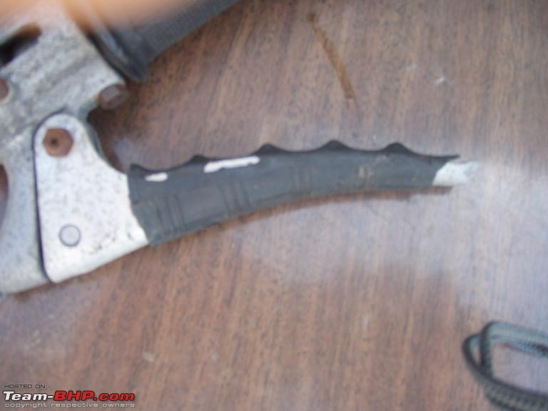

1977 Suvega moped type AV 44 parts
Hi,
I am looking to restore a 1977 Suvega moped type AV 44 here in California and I am looking for some original Indian parts for it. I have attached a few photos. The headlight is "Beepee" marque and is 100mm across. The reflector says "Carex" and "India" on it and is 43.80mm across. Finally, the brake levels appear to be "Indola" marque. Are there any available? Anyone have these parts? Thank you.
Richard

Hi:
The brands you have mentioned above make these parts for many other motorcycles, for instance Indola made rubber parts for almost all the two wheelers. So it is not the lever but the rubber sleeve on top of it made by Indola. These were not fatory fit ones, but aftermarket. These parts will be available online. You can search for Motobecane parts. If you still want me to check locally in India, I can do that.

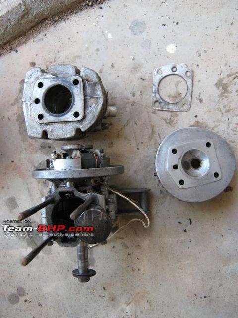

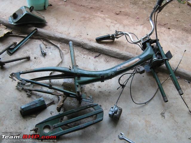

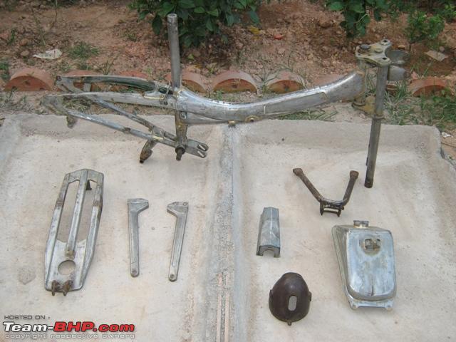

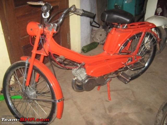

Finally I got some work done on my Suvega.
The nice satisfying thing is I painted this myself.......The Art of Painting.
To explain it in short......
All parts stripped down and cleaned using CAT brand paint remover and washed thoroughly.Luckily there was no rust or any breaks.
Primer coat sprayed and putty applied wherever needed. After washing the surface again, surface coat sprayed and so on the paint.
All chroming was done locally.
New seat, spokes and new silencer was sourced from Coimbatore.
Pending works - Fixing headlight and stickers, does any one have stickers ?
Anyways......here are the photo's

Dear Gpv,
really amazing!!
Nice work in there!!
If you would have re-painted with the same Emerald green( 'coz Only few Box Suvegas where sold, that to with only one color scheme - Emerald green), it would have been great idea!! any way past is past...keep it up !!
BTW, how come you find time to do all this, during short stay in India?? (90 % of time you spend in sourcing parts , bikes & stuff)
Can you do a paint job for my Bantam,if you don't mind????
ps: My humble request to all : For Heaven sake don't go for Paint removers, that to for TINY machines like Mopeds, with intricate shapes & profiles..I swear there is no Foolproof method to remove all the Paint remover from the parts, so there are plenty of chances ,for PR to get trapped in between edges of the parts.

I was thinking of same green color, but for some reason I wanted bright color.....no worries after 2/3 years, will change back to green.
