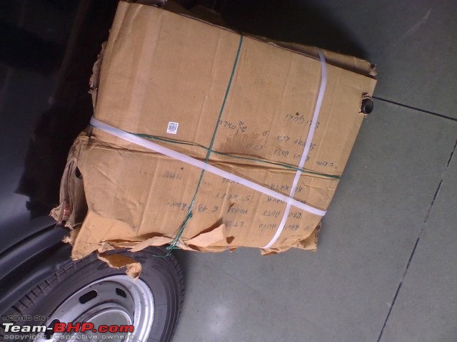

@ Mr Dhabhar - thanks a whole lot
it will be great if you can post High resolution pictures of the engine bay of either the LHS padmini or the red/black one - it will be great if the pics are clear and self descriptive. i am sure Cyrus will be able to help.
Thanks a tonne
ps: got hold of a NOS closed type radiator after a lot of search
The FIAT 1100/Premier Padmini Technical Information thread-nos.jpg
