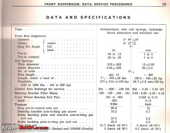

Originally Posted by funkykar View Post
My mechanic suggests to put a 9 coil spring instead of the 8 coil spring and also put thicker spring pads. Is this the right solution? What bothers me is, when my S1, to the best of my knowledge, has all original spring, shock-absorber etc, why is it lower than the other PPs?
Dear karthik,
Please don't change spring to a different one, it will un-necessary alter the properties. Please refer the Technical workshop manual which refers to spring height of the coil spring under laden condition and also the free length.
Check this and if the spring is not confirming, discard and use a new spring.
I am attaching a screen shot from the Fiat 1100 Technical Workshop manual, don't know if Premier Padmini shared the same specs or not.

Dear Karthik - the reason for reduction of suspension height in your car is as follows:
In the front, the coil spring is known to take a permanent set, this issue was there in our test cars also. Fortunately, the coil spring has two noise suppressor rubber rings located at both ends. Also, fortunately, higher thickness rubber rings are still available, at least in Opera House Mumbai. I suggest please use them to gain a little bit of suspension height in the front. Use of these rings will not affect camber and caster setting capability, but you will have to set these parameters once, as the number of shims will change (mostly reduce). In extreme cases, you will need to use the first oversize upper control arms, but this is a rare possibility.
In the rear, private cars were supplied with 8 leaf rear springs. Black economy taxi cars were supplied with 10 leaf rear springs. There is nothing like 9 leaf rear spring, or oversized spring pads, if somebody is mentioning such things, he is talking nonsense. The leaf spring shackle bush life was never very good, shackle bushes are prone to shear failure due to turning in the spring eyes or cross-wear. So please sleep below the car from the back and very closely see the shackle bushes. Replace if required. When you renew shackle bushes, you must orient them at the correct angle which is given somewhere in this thread itself. The other causes are weak rear shock absorbers, but this is low priority, because the specification of load v/s deflection for unladen RAW is much more on the higher side than necessary, and worn stabilizer bar bushes, for which there is no direct correlation or explanation, but the end result is always good, so try it first before attempting the shackles replacement, you lose nothing by doing so. Whatever happens, for God's sake PLEASE DO NOT ADD SPRING LEAVES! It will be the beginning of the end of your car! If you enjoy a good 1000 kms drive, get your car to Mumbai, then everything will get done! .
Dear Sandeepmohan - radiator hoses are readily available, at least in Mumbai and Pune. Cut the hoses to correct length to prevent them from pinching when fitted. Use good quality hose clips to secure reliable leak-proof joints. Please post a photograph of your car's radiator so that I can comment on it.
