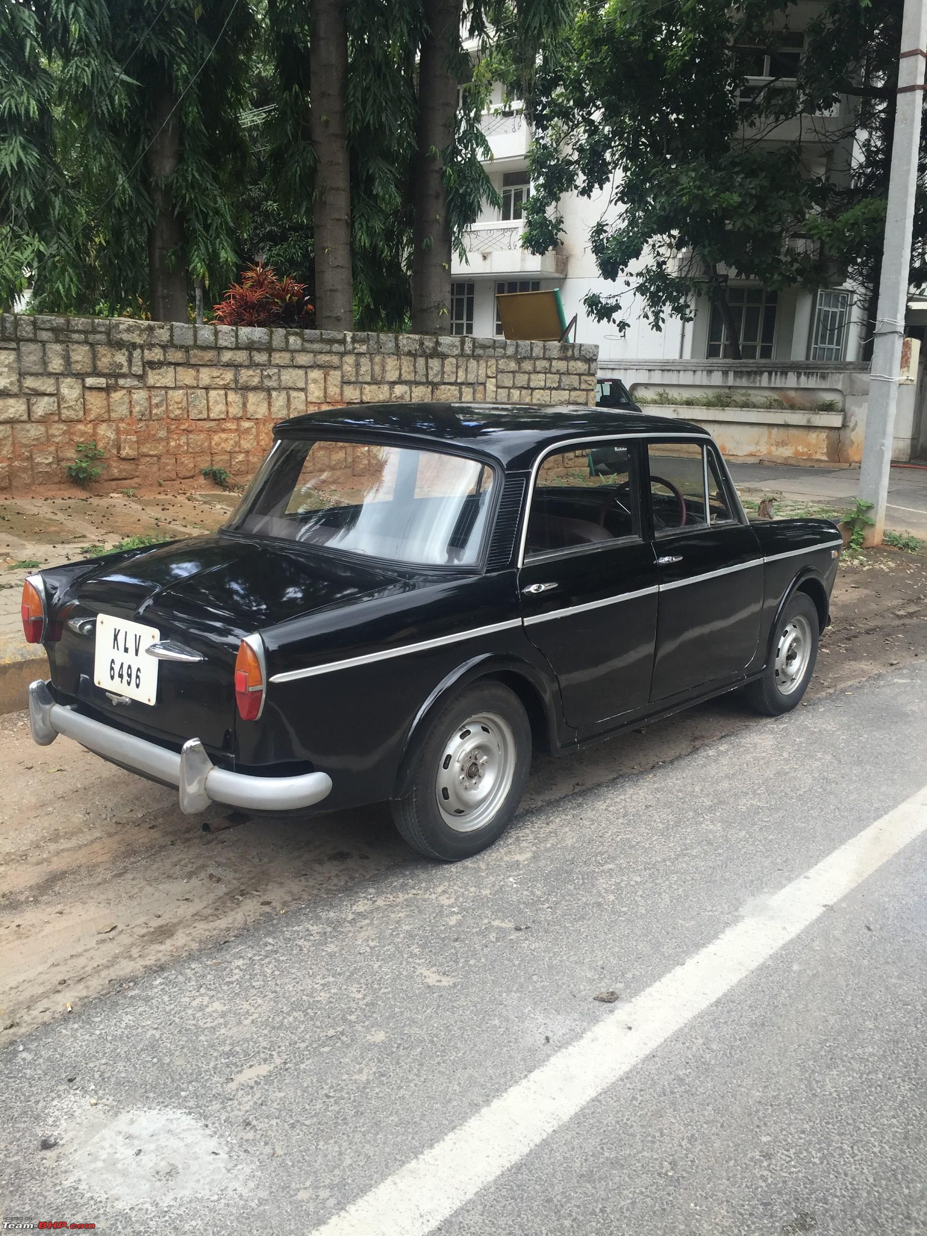

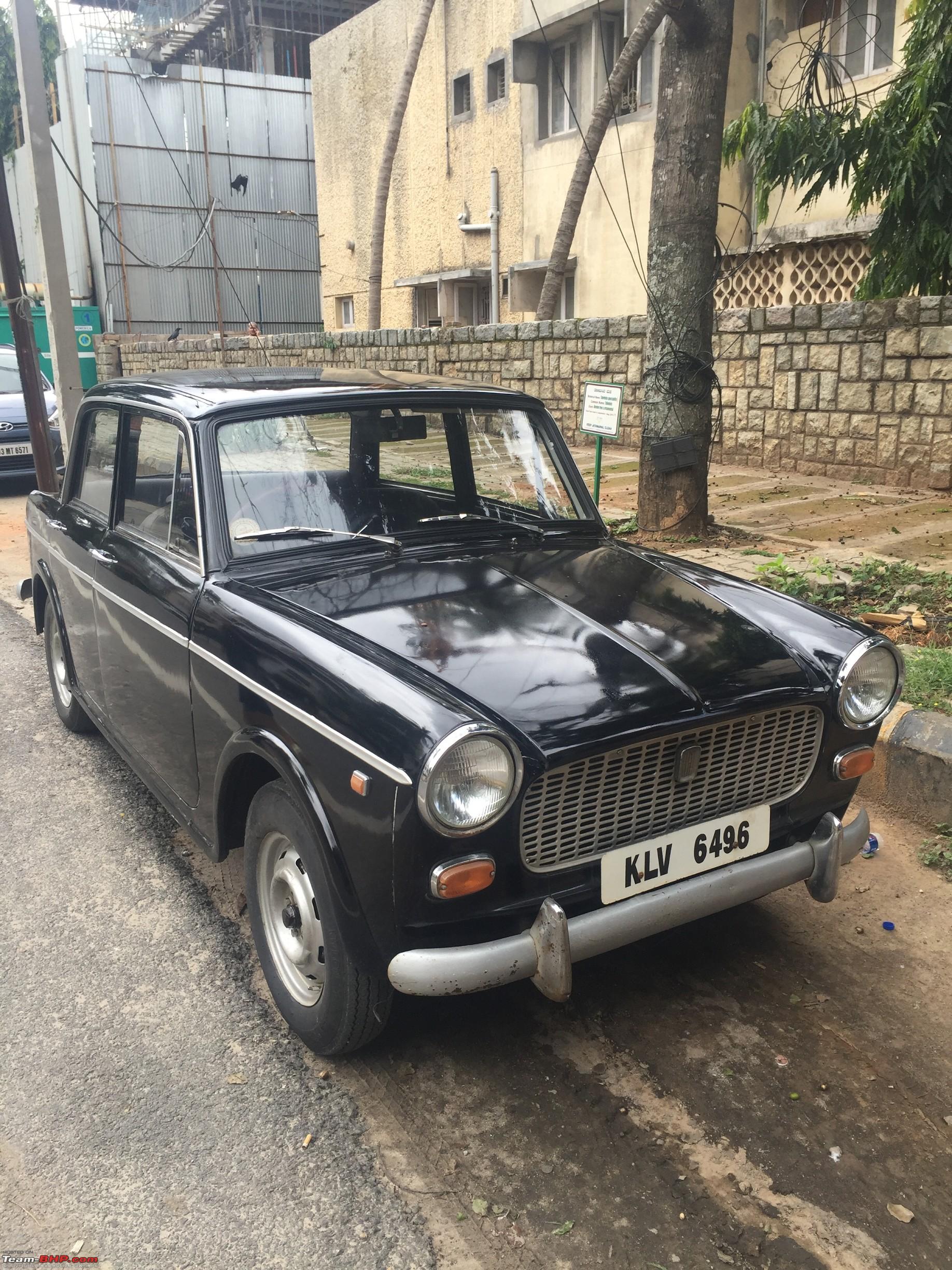

A better picture of my 72' Fiat 1100D.
Attachment 1535505
Attachment 1535506
try to get the original plain coloured park light lenses.
