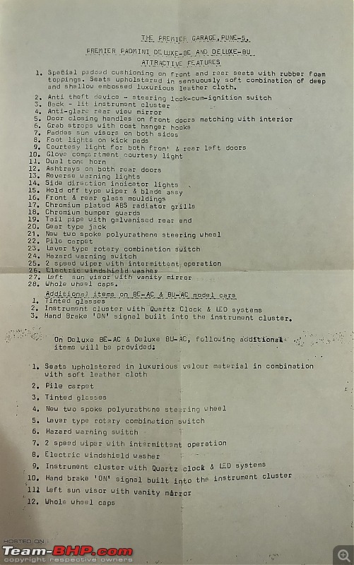

A comprehensive equipment list with differentiation between variants. Unfortunately not dated.
Attachment 1695748
Looking at the equipment list, this looks from the early 90s.
