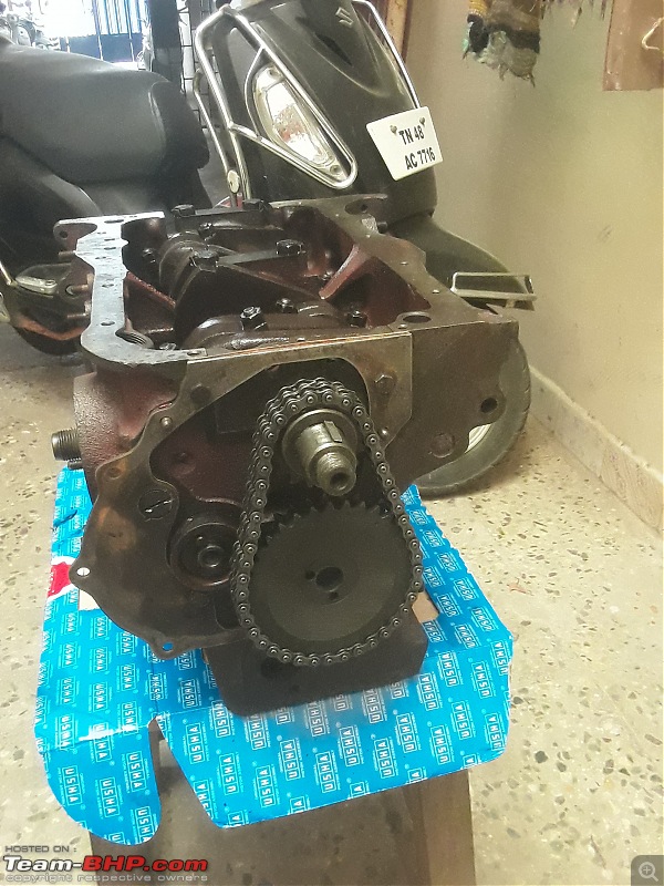

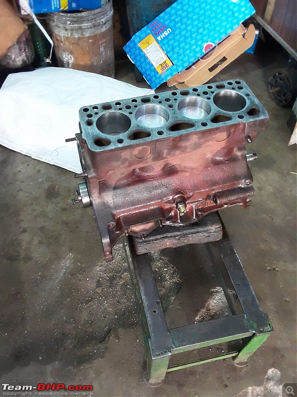

Did cut a few grooves, though not expecting a miracle to happen as the rest of the mechanicals are 70000 kms old. The head will go into the car by this weekend.
Here is ann update after a long break. As the piston was work out, just a head job did not fix the smoke issue. Blowby was still there. I had to decide whether to go the DIY route or handover the rebuild to a mechanic.
Now that I have been working from home and the travel time to office is saved I could use this time to pull out the engine and get the job done. On a weekend my cousin turned up to help me with getting the engine out. Getting it out didnt need a crane. We first removed all parts like head, alternator, AC compressor, fuel pump the engine shed lot of weight. 3 people were required to get the engine out of the engine bay.
Again removed the head and this time gave the cylinder block alone to another guy. I had provided all the parts needed. A new 2nd over size piston & ring set along with 1st undersize crank bearings went in. Cam bushes were reused. The engine guy took 10 days to handover the finished engine.
Now I had to assemble the oil pump, timing chain kit head and other accessories into the block. Yet another weekend job it was.
