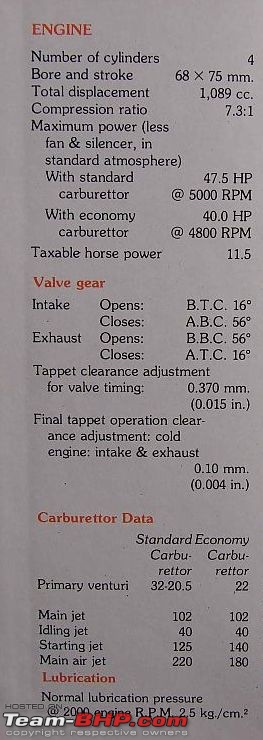

Specifications of Engines of various models of Premier Padmini. Each one is different!
Adheesh posted this:
The FIAT 1100/Premier Padmini Technical Information thread-dsc02929.jpg

The FIAT 1100/Premier Padmini Technical Information thread-scan0004.jpg
Premier Padmini Economy(i think so)
The FIAT 1100/Premier Padmini Technical Information thread-scan0003.jpg

The photographs you have posted are from manuals for cars from 1988-1991/2. The photographs I had posted were from the manual Hrishikesh had which probably seems to be from an earlier model (since the compression ratio is 7.3 compared to 7.8 on later cars ). The 88-91 have a larger venturi for better fuel economy (and perhaps to meet the 1991 emission norms) but this reduced the street drivability. My 1991 standard car came with a Bicsa from the factory. Also my ex-1988 deluxe car had the 24 mm venturi configuration on which I and President had done 135kmph while getting the car from Pune. Later on I replaced the venturi with a 22mm one and the performance further increased however the fuel economy came down to 6-7kmpl !!

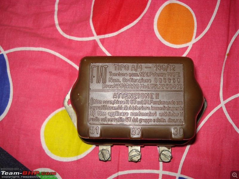

Behram Ji,
Attached please find the picture of the cutout regulator. As you said I need 264 W. I saw the owners manual of elegent and it says 180 W regulator. The battery is 28 Ampere Hour. so 12 * 28 = 336?? I am confused.
For the Select it says 230 W regulator. The battery is 32 Ampere hour.
32 * 12 = 384
And to add to the confussion I have Exide MHD 700 Battery of 65 ampere rating.
But then these regulators can be set by some experienced persons, so I believe this will also work.

The FIAT 1100/Premier Padmini Technical Information thread-dsc05593.jpg

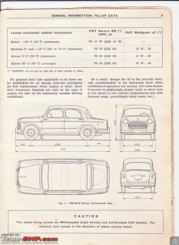

FIAT Service Department had issued this manual in 1962. I have taken a few pages scanned and posted. The specification given for various models are annexed.
The FIAT 1100/Premier Padmini Technical Information thread-premier-padmini-book.jpg
The FIAT 1100/Premier Padmini Technical Information thread-premier-padmini-book-001.jpg
The FIAT 1100/Premier Padmini Technical Information thread-premier-padmini-book-002.jpg
The FIAT 1100/Premier Padmini Technical Information thread-premier-padmini-book-003.jpg
The FIAT 1100/Premier Padmini Technical Information thread-premier-padmini-book-004.jpg
The FIAT 1100/Premier Padmini Technical Information thread-premier-padmini-book-005.jpg
