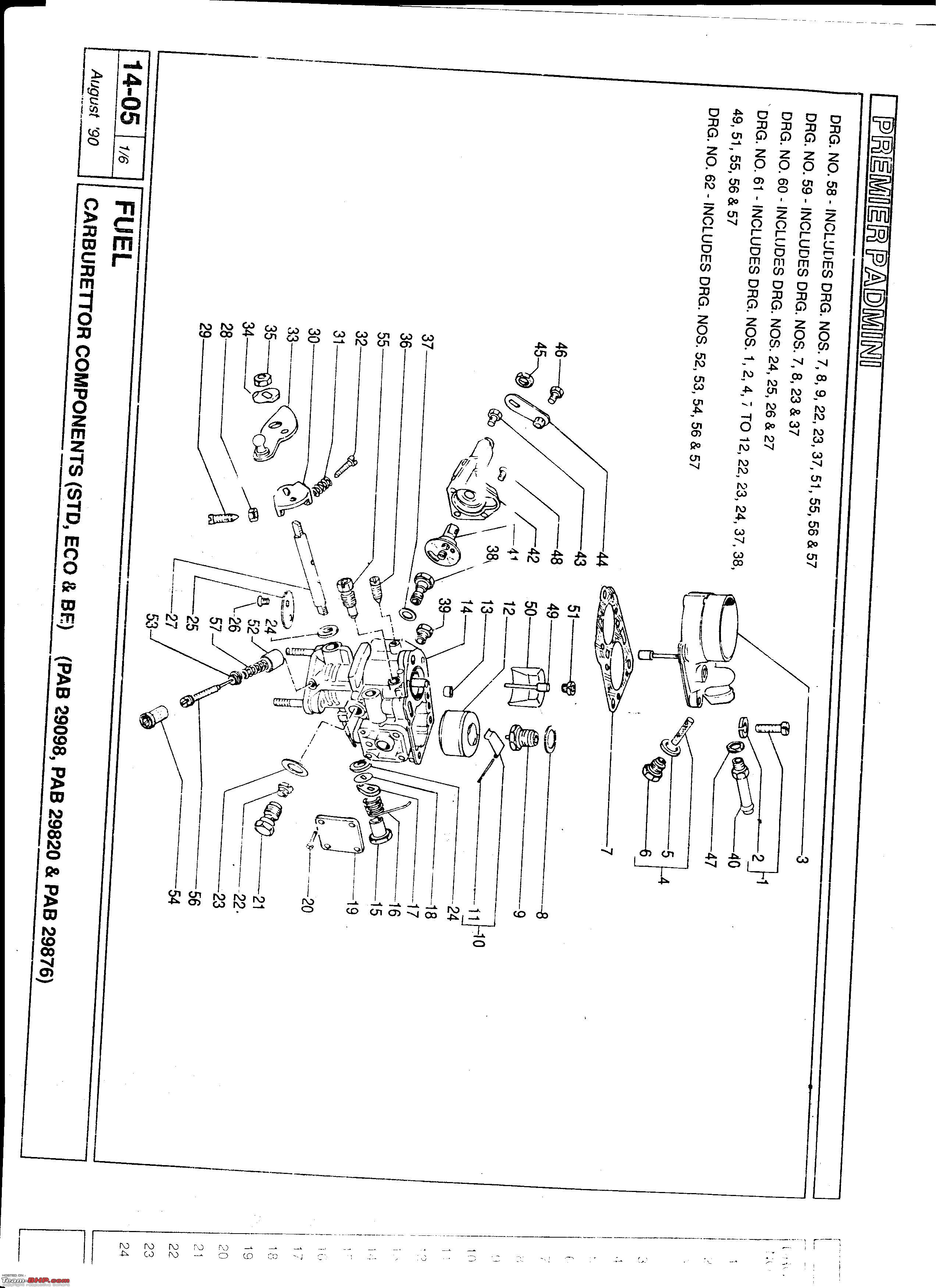

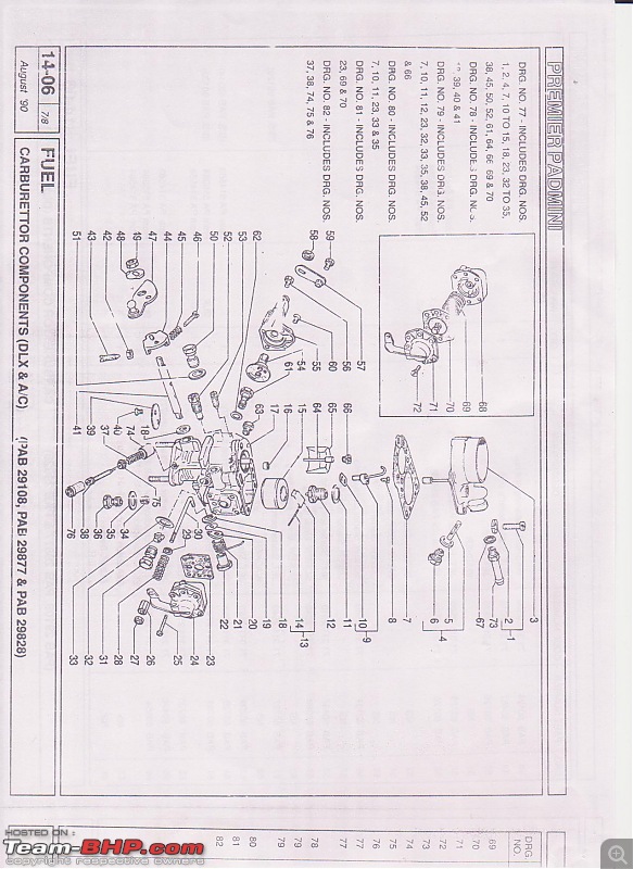

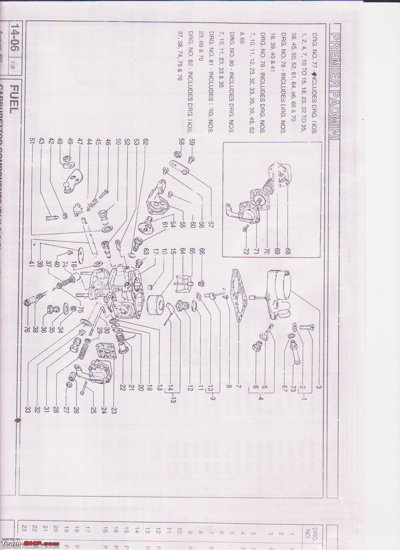

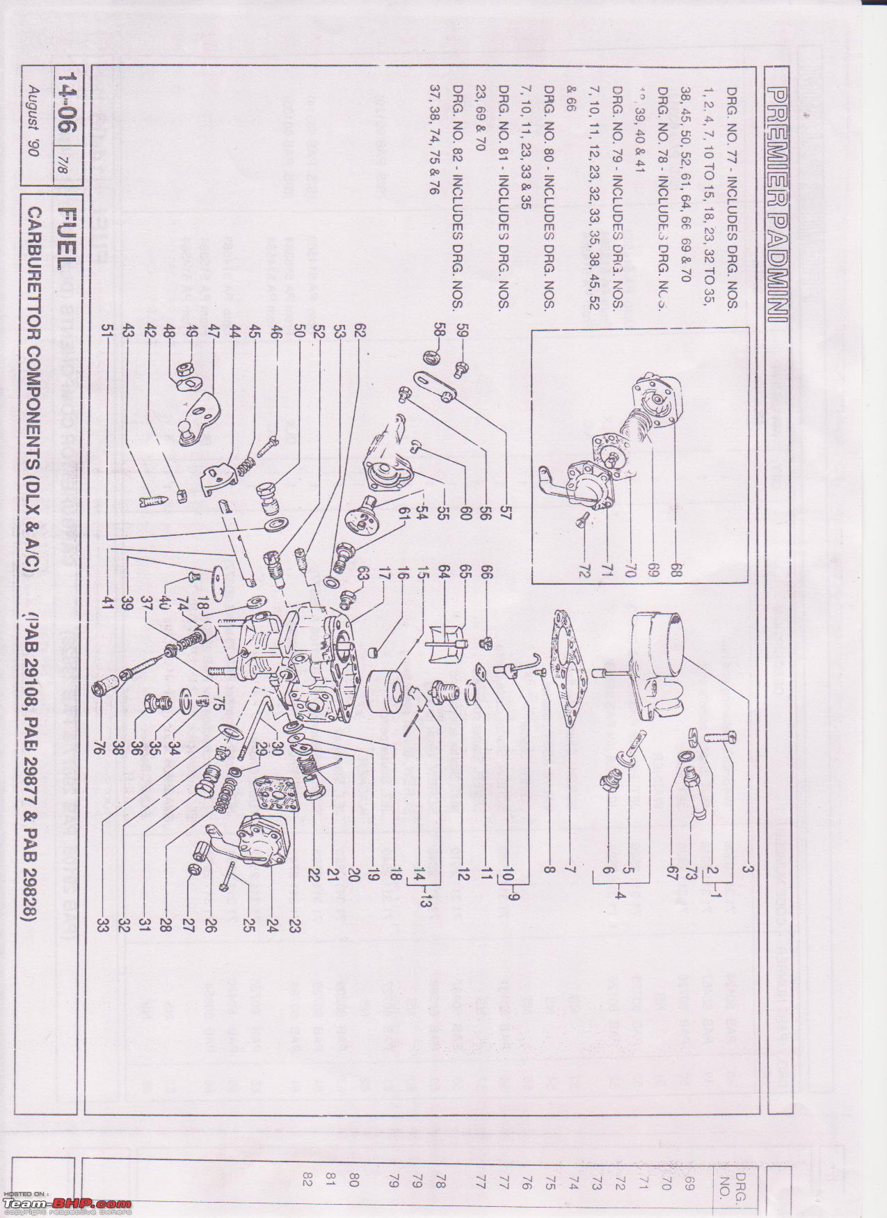

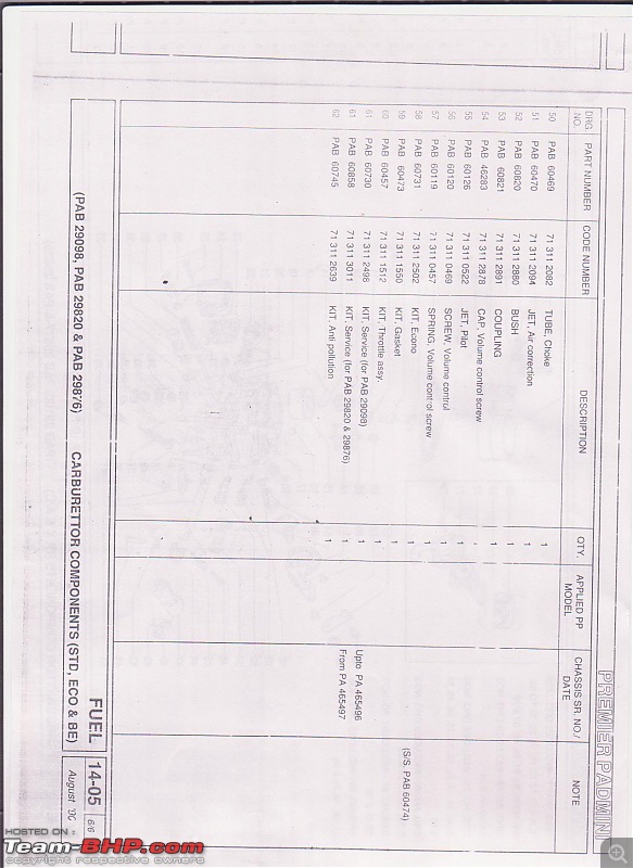

padmini carburettor
Padmini Carbuettor totally dissected across all models!

Thanks Gururaj ! However the Bicsa carburetor was never documented in early stages of its introduction in Padminis. It was only in the S1's that Bicsa was documented on the brochures. However I dont know if the S1 Parts Catalog (if there was any) has Bicsa documented in it.

Yes Mr Adheesh! The earlier manual mentions about Solex and Weber Carburettor! The S1 model came later and as I own only the earlier model to S1, I took care to collect only the manuals meant forthat vehicle. Thank You.
