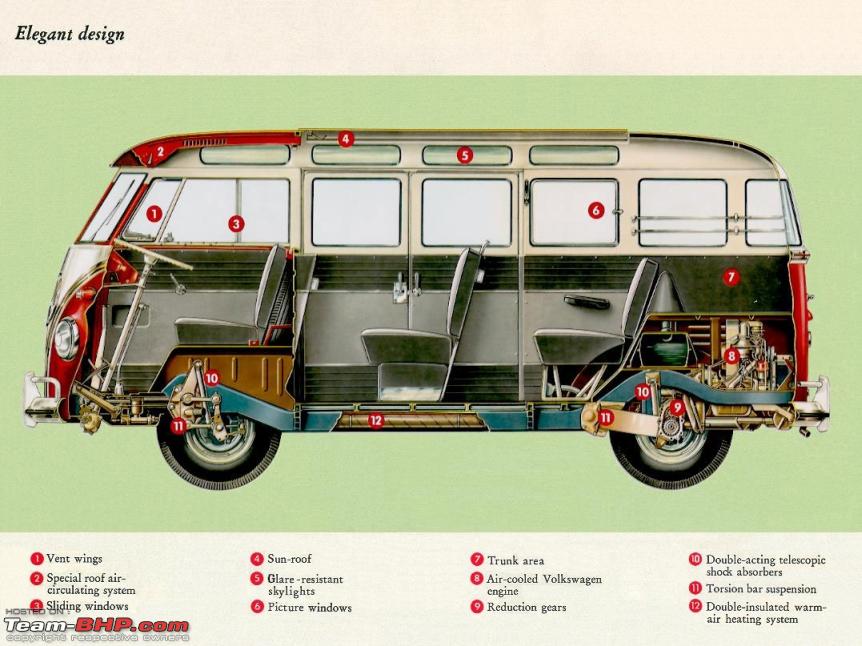

Default Some Pics !
I found some pics that might be of interest to you Pavan. I am still waiting to hear from you about where you found your mini ?
Look at this guy !!!
This might help.
Restoration of 1971 VW Baywindow Microbus: Restoration Complete-vwmini.jpg
