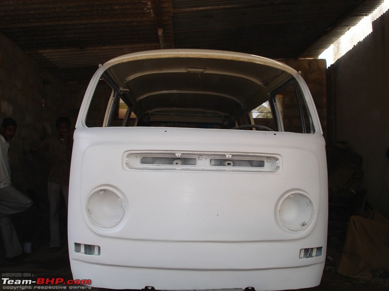

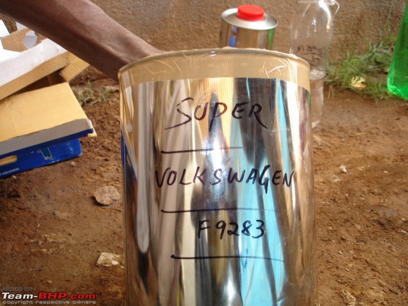

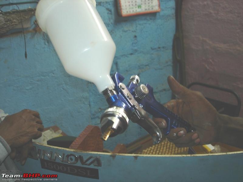

Now with the regular updates
All set for painting, the Bus now gets ready for painting.
As per my procedural approach, we go about like this, since the paint decided is two shade. Top and pillars will go with white and the rest of the body will get painted Yellow.
These shades were decided after lot of discussions at home, doing a lot of permutation and combination of colors. The paint shade was an original Volkswagen shade from Dupont(White - Reinwelib white F9283 and Yellow - Zitrus P4930).
1) Get my painter a new spray gun
2) Paint the wheel arches yellow
3) Get the White paint to complete the Roof, Pillars and Bumpers
Let the pics speak.
Restoration of 1971 VW Baywindow Microbus: Restoration Complete-dsc08027.jpg

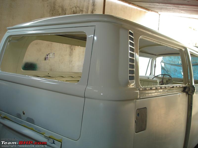

And some more pics
This paint needs to dry for atleast 3 days, after which the whole top and pillars will be masked, dull the body parts where the white is being oversprayed, and then start with the yellow.
The final coats of yellow will go in probably by this weekend. Taking it a bit slow as i want to stay when the painting is done. Weekend being an off at office will complete.
Restoration of 1971 VW Baywindow Microbus: Restoration Complete-dsc08102.jpg
