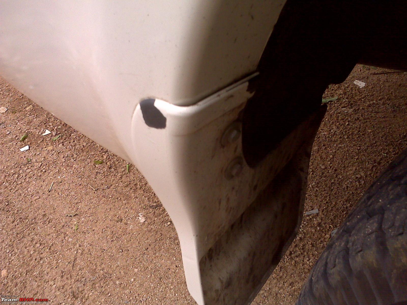

My 8 month oldie has chronic seemingly unsolvable problems
1, Completely Jammed power windows on passenger side. earlier they would start working before servicing - and they would do some tinkering around - now completetly jammed - what should I ask for in next visit to SC?
2. My passenger window every 2-3 days comes up with grease on the window pane. Will lose my rather expensive sunfilm if I keep applying those solvents to remove the grease.
3. Very fast discharge of battery on the key? not that I keep it pressed - twice it has been changed by service center.
4. Moisture in one the headlamps - anyone knows full proof way to getting it cleared w/o going to service center?
5. The mudflaps at the back - one of them has started cracking and the other one is getting chipped. It goes offroad but I am careful - dont know what has been causing this damage. will they replace under warranty? anyone knows any other more "flexible" and robust options than the default.
Otherwise a painless and pleasant drive so far.

My suggestions below, these are minor issues and be taken care at the A.S.S. easily:
Window Driver Motor replacement, insist on it.
Get the panel opened and have the exces grease cleaned.
Get the remote replaced (does it happen on both of them ?)
Temp. solution is to use a hair drier and get the selent around the headlamp checked.
Not sure if they will cover a plastic part under warrenty.
