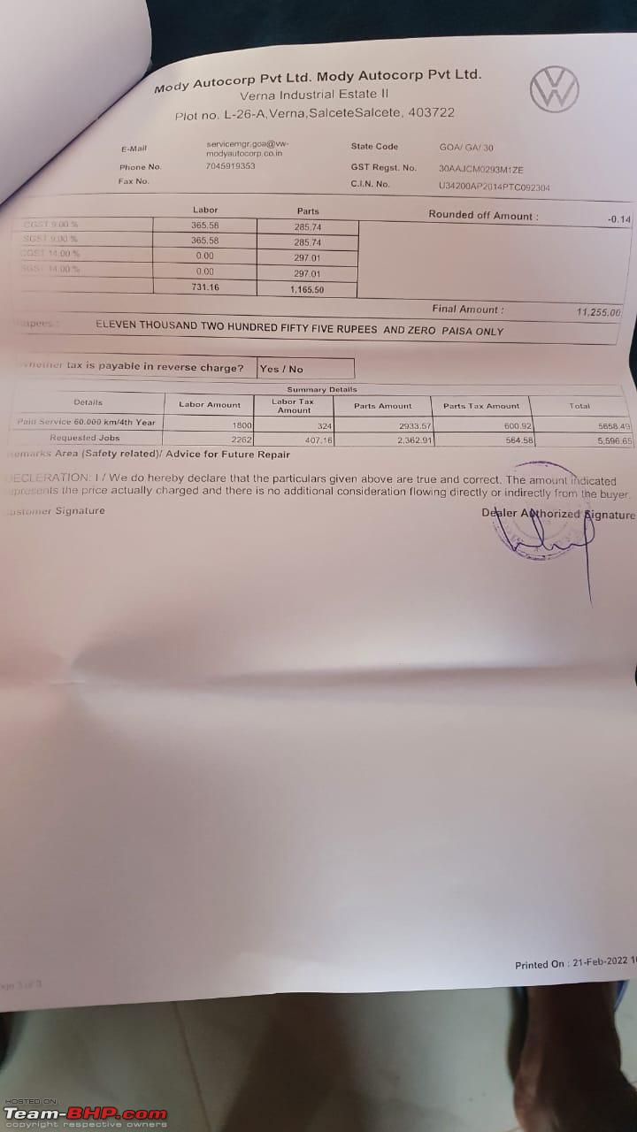

I got the 4th service of my Polo 1.2L MPI done last month at Mody Autocorp. Attaching copies of the invoice. Got wheel alignment done there too, as well as an add-on warranty for the 5th year. This was the first time that the wheel alignment was done, since the car has done just 16,000 kms.
Upon being told that the final invoice amount was Rs. 11,255/-, I wasn't too pleased considering that the SA had added a Carbon Activated Air Filter and some unexplained 'Parts consumables' costing Rs. 1,000/- under Requested jobs without my consent. Unfortunately, he happens to be an acquaintance, which is why I just let it pass. The Add-On Warranty cost was Rs. 10,219/-. Apparently, since the 4 year warranty expired in January, the Add-on would only be activated 1 month after paying for it - something that the SA mentioned only after I swiped my card.
Also, the sales guys have goofed up the sale date. The car was delivered on 18th Jan 2018. The same date is mentioned on the tax invoice. However, the date of sale on the Add-on warranty is given as 30th Oct 2017. When I enquired with the service center, they simply washed off their dirty hands stating that the data was entered by the sales person and it can't be changed.
I now regret the decision of getting the car serviced there, considering that there is a way better FNG not too far from where I live, who would have serviced the car for just around Rs. 7000. The only reason I did it was to get the warranty extended, considering that I had 5 ABS sensors replaced under warranty over a period of 2 years.
