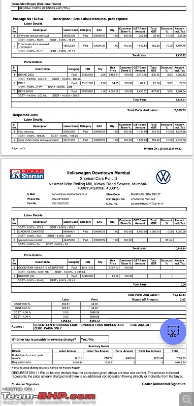

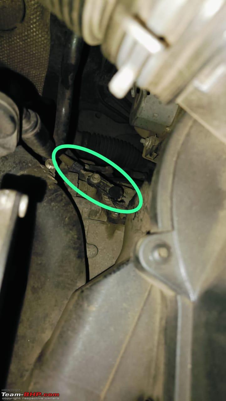

I have been given the below quotation for 2019 Ameo HL+ TDI DSG. I really never understand the billing format of VW.
They have identified two issues:
1. DSG Cable Connector to be repaired (Apparently new one costs Rs. 70K)
2. Brake Pads to be replaced
I have their AMC where some percentage of discount is entitled on part change. They have shown the discount however not given one. Need help to know if the charges are correct. What is Machine Charges, that too Rs. 7k?
Maybe the lathe machining charges, where they will need to skim the back drums. Other than that, I do not know why you need to machine anything else. They are removing and replacing the rotors, so they do not need any skimming. The machining may only be for the rear drums, which is also through the roof.
Local lathe shops charge around, 600/800 for one drum, 7k is a huge jump. In case of the DSG cable, it is called a bowden cable. These are available for 6k to 7k online on Boodmo, if they are referring to any other cable, then I might be wrong. Hope this helps.
Happy Motoring!

[quote=VWAllstar;5867833] Rip off. I did a brake job myself on my Polo yesterday. The machining(turning) of rotors(two) cost me Rs. 1200. Mine is a small town but it should cost you no more than 3000 anywhere in India. Hardly do you need to turn drums as they do not normally get scored. The brake system in VW is made/supplied by TVS-Girling and they cost much less than what appears on your bill. A good parts store will have everything for you to do the job. My suggestion would be to get the cable work done at VW but get the brakes done by a good FNG. If you want to do it yourself, there is Youtube. It's a straightforward job and perhaps the easiest when it comes to car care. However, you need tools and have to jack up the car. Personal safety involved, mind you.
