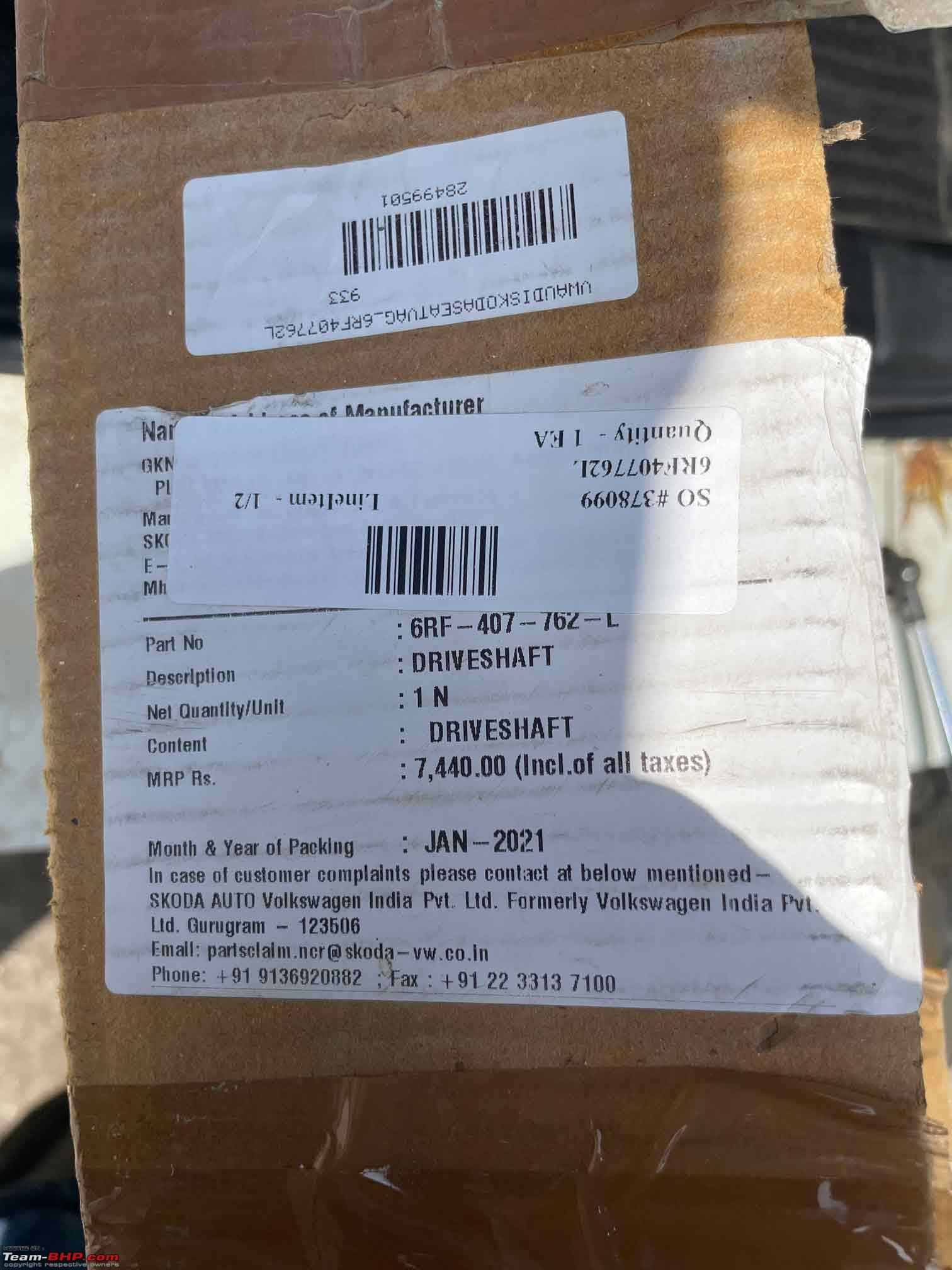

Update on my Polo is that it's almost done. The final repair thing left was to replace the Right Axel, and an Engine Mounting.
Since the experience with the VW Authorized workshop was not too good, I decided to get the rest of the work done with my trusted local mechanics Harvinder and Kumar, listed in the Team-bhp NCR Directory.
They had already done the entire suspension work, replacing all four Shocks, link rods, Lower Arm bushes etc for the Polo.
Since they could not source the Right Axel and Engine mounting we decided to order these OEM parts from Boodmo. I have my Polo added to my Garage on Boodmo with VIN.
I ordered the parts shown compatible for my 1st Gen Polo 1.2L Comfortline Petrol. Both the Part numbers received are correct as shown but both these parts are slightly different and will not fit. Unfortunately the parts were delivered 12 days ago (Outside the 10 day return Windows of Boodmo), my mechanics were free only today to install these, and that is when it was discovered the parts will not fit.
I have regularly been ordering parts for my Grand Vitara, and Camry from Boodmo, and if the Part no is shown as compatible with my car it has never been a problem. Is it any different for VW Parts, can it not be trusted that the Part numbers shown for a model will surely fit ?

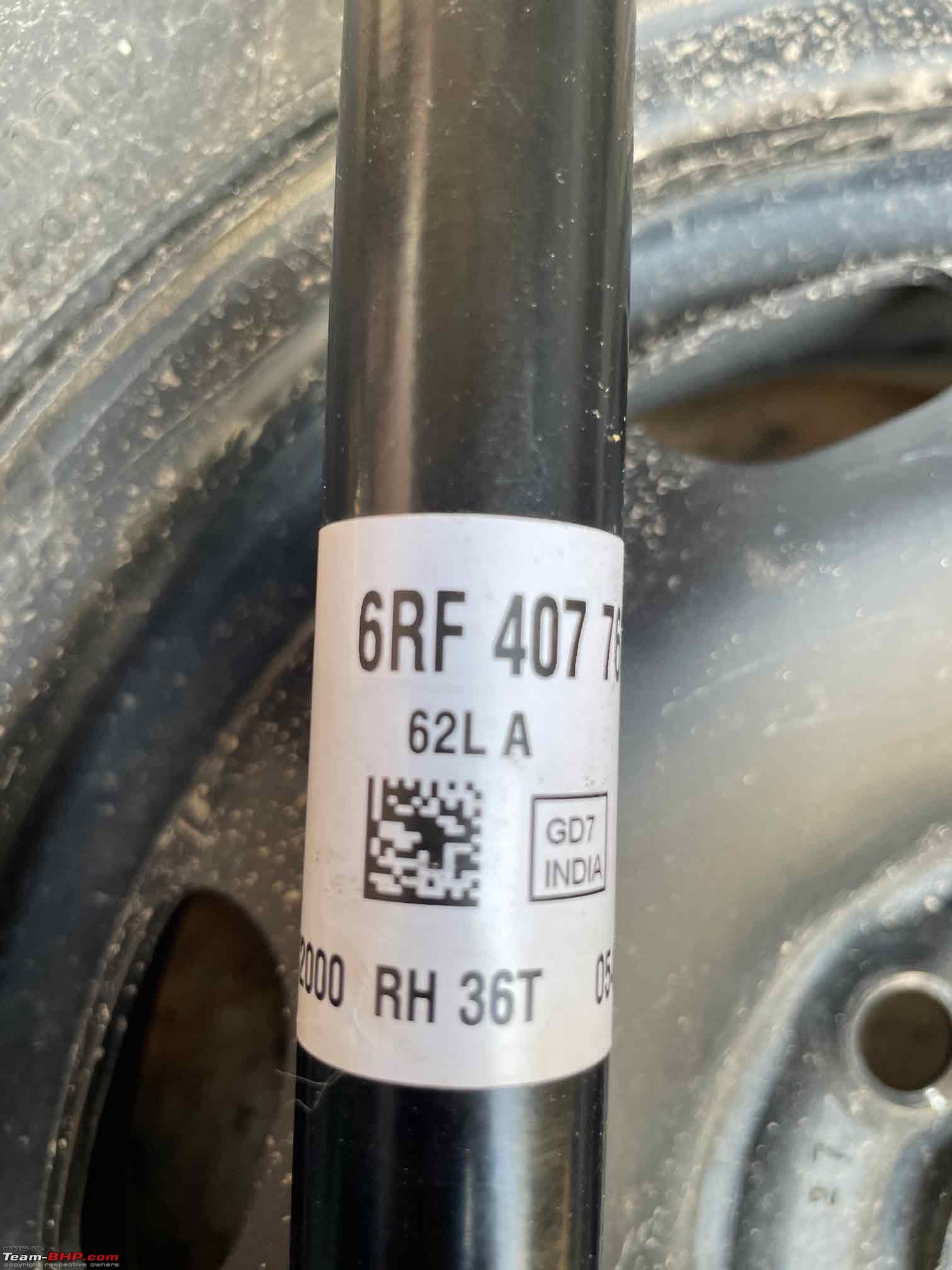

Two parts ordered that will not fit are :
1. DRIVE SHAFT WITH CONSTANTVELOCITY JOINTS (Front Right Axel) Part No: 6RF407762L
The Length is the same, but the grooves for fitting is different.
2. ENGINE MOUNTING Part No: 6RF199262M
Only two screws align and the third screw is out for Alignment.
Attaching pictures here for reference.
Any idea what I could be missing ?
Styler
Update :
I just had a word with Volkswagen.
They have told me that these parts that I ordered are for the Polo Diesel. These are wrongly shown as compatible for 1st Gen Polo 1.2L Petrol on Boodmo.
The correct part numbers for the Petrol Car are the following:
Drive Shaft - 6RF407764H (https://boodmo.com/catalog/part-6rf407764h-28499508/)
Engine Mounting - 6RF199262P - (https://boodmo.com/catalog/part-6rf199262p-32231485/)
I am taking this up with Boodmo now to get the parts replaced.
