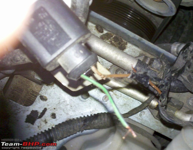

Yesterday, I noticed that the indicator indicator (err, the arrow lamp on the dashboard) was flashing at double speed. When I got home, I realised that this meant, "You have a problem."
VW Polo - Maintenance and Service cost and dos/don'ts-rats1.jpg
(That's the right, front indicator lamp, removed from its housing)
Rat damage. Also here:
VW Polo - Maintenance and Service cost and dos/don'ts-rats2.jpg
The severed wire I have twisted and taped. The damaged wires I have just taped.
What is the recommendation? The way this stuff appears to be made, it would be necessary to replace an entire wiring loom section, which I'm sure is costly. Any experience or recommendations?
Attachment 1016618
Attachment 1016619
RATS! Sorry to know this.
Best is to change the wiring loom since the damage is very close to the molded connectors. Maybe only the section damaged can be changed?
Insurance should cover this?

If it is just a few thousand, I wouldn't bother with the insurance. But this wiring loom doesn't look cheap.
Rats! indeed
