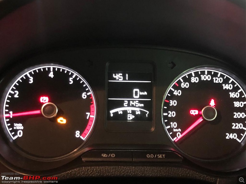

Hello Bhpians,
Need some urgent advice, My 2021 Polo TSI has thrown up a CEL after just 2145Kms and <2 months of ownership. Owing to the lockdown in Maharastra I am unable to contact anyone from the Service Centre here and I am at a total loss of whats happened.
The CEL came up while returning from an essential only run, it was not a spirited drive and I don't think any of my actions could have thrown up the CEL.
The car has been however parked in the basement for almost a week and I suspect a rat bite, however, the rat bite should have thrown up Christmas trees on my dashboard. I checked all the fuses and none of them are blown.
P.S. The car just underwent its 1st service at the beginning of this month. Any major cause for concern should have been ideally caught at the swagaat service/inspection.
VW Polo - Maintenance and Service cost and dos/don'ts-whatsapp-image-20210427-1.46.40-pm.jpeg
Any advice is appreciated. Thank you.

Originally Posted by KA19Rao View Post
CEL
Looks like this is your first VW ownership experience
VW cars love throwing this one, especially if it comes while the engine is running, I have never even stopped paying heed towards it. Normally this one is associated to your exhaust and the pollution stuff, and you can keep driving around. If some other light also comes up, then it's a matter of concern.
My experience says that this light normally goes away either in next start up, or in a few days by itself.
My response is purely based on my personal ownership experience, I am a 'less sensitive' type BHPian and have expressed what I follow. Well, I simply ignore and keep driving. This one is such a elusive light, that it never accompanied me to the service station till date. So, check in next start up, or the one following it, the light will probably go by itself.
Hi VKumar, I got the CEL yesterday afternoon, it's been several start-ups later and it still has the audacity to remain on .The same was also mentioned by my SA and asked me to let it be for now. Due to the lockdown, I have no other choice but to wait and try to diagnose the problem myself.
KA19Rao is offline   (1) Thanks
Around 4:45 I suppose. Your car clock is showing 4:51, and I expect the VW clocks to gain 1 minute per month, the Ze-Germans are fast in every manner.
Quite stubborn I must say. This is the unique way of 'The Polo' of keeping you involved while in the ownership.
It's like the tantrum that doesn't end up in a breakup. When you are living peacefully; partying, and dancing with the friends; she suddenly throw this light (tantrum, that unexpected phone call) to make her presence felt, and add some adventure to your life. So, learn to live with it.
Last time when I got a stubborn one, all I did was:
1) Go to FNG and get throttle body cleaned
2) Remove battery negative terminal and put it back after a minute.
The light was gone. Since it's a lockdown, you can try the step no. 2, that resets everything (including your clock), but the light is known to go away after that.
51st Shade of Grey: Even while you open the negative terminal clamp, you will love the way it's done. Unlike the simply round clamps that Indian or most eastern cars get, Polo has a proper piece of engineering tightened even on the negative terminal
Stubborn CEL solution no.2 was a no bueno. Left it for a whole minute before reconnecting it.
Stubborn CEL solution no.1 might not be stretch as the EPC light remains on for about 3-5 secs after the ignition is twisted. (Surprising if this is the solution as the car is basically still a toddler.)
Funny how I have managed to avoid such personal relationships in life just to finally end up in one with my car.
You have provided me with a lot of insight into Ze German ownership.
