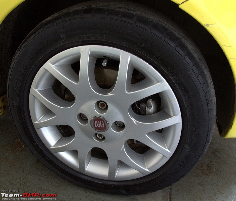

So I finally cleaned the tyres! APC 1:4, scrub, clean and Hyper Dressing 1:4 on tyres. Alloys just wiped with a damp cloth

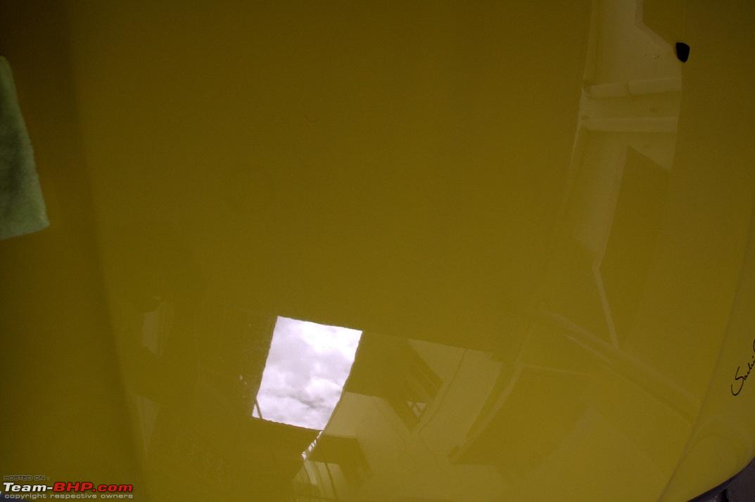

Sprayed body with remaining NXT car wash+water from sprayer on the body, wiped it down adn gave a coat of M26. Result:
Reflections:
