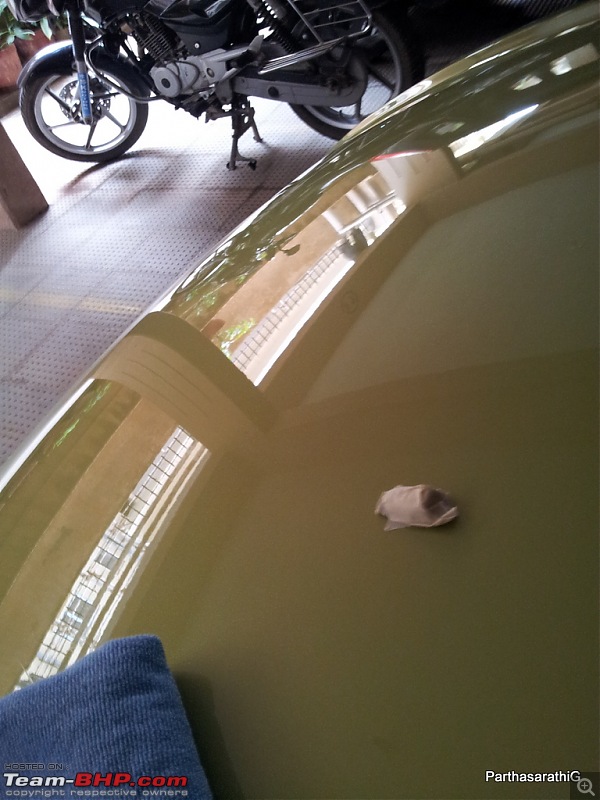

So I decided to follow through with Ultimate polish and the results were amazing - called up @Notorious to clarify on the technique.
here are some pictures after an IPA wipedown as UP leaves behind oils -

Some pics after applying Wolfgang DGPS 3.0

The last few pics I took with the dSLR just to capture the clarity of reflections plus some of the deeper (few) swirls that need to be removed. All in all, I was blown away.

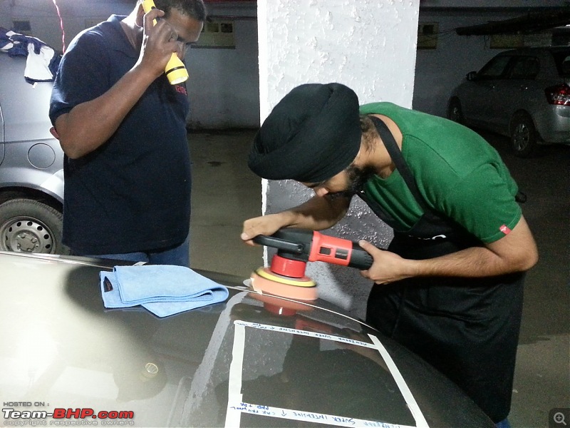

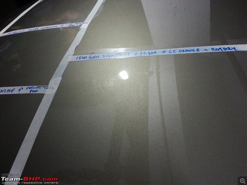

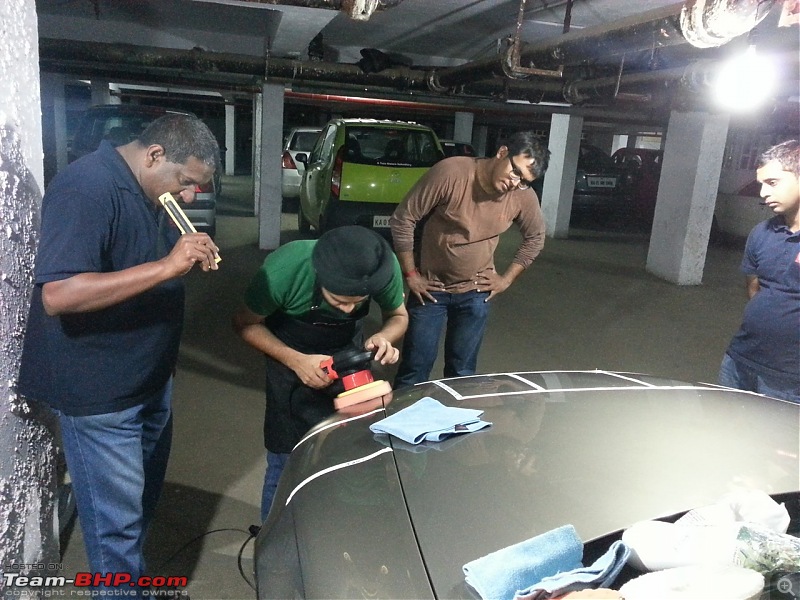

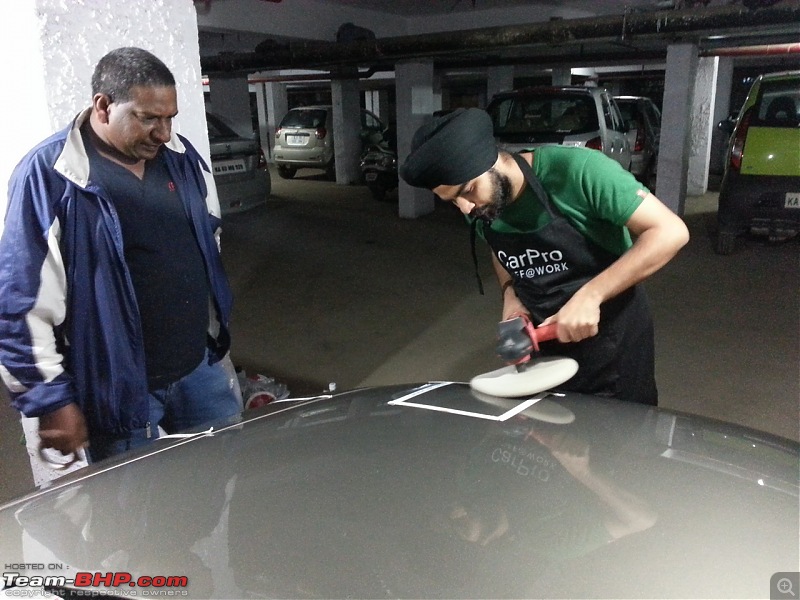

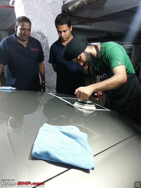

Meanwhile, day before yesterday, I got a call from Nirmaljusdoit of an impromptu detailers meet - since @Notorious was in Bangalore. Sadly I was out of town on a ride and missed most of the discussion - but decided to catch up with them in the evening since I had been wanting some training with the machines for a long time.
It was an interesting session - to see all the great minds at work. I was humbled by their knowledge of the subject. I realised I know only 10% of what they know, but this has only strengthened my motivation to learn about it even more.
It was a pleasure to meet @Notorious in person, someone with whom I had only been speaking over the phone for the past few months.
@Nirmal was kind enough to allow me hands on with both the rotary and dual action Flex polishers and menzerna compounds which were being tested. One word for menzerna - amazing. FG400 finished without even needing a second step - it was amazing to see such results.
Mr. Hari of Greenzcarcare was also present and I got to try out some CarPro products also - like the wool pad etc.
The Keystone team was also present and were very helpful all throughout. Atleast now Im not that scared of a rotary.
Man, Jaspreet aka Notorious has magical hands.
Some clicks from the meet :-

The last few pics I took with the dSLR just to capture the clarity of reflections. I was blown away.
That's some pro results there Partha! It looks like the Kestrel DAS 6 pro is a real good vfm machine with which one can achieve good results with the right technique.
