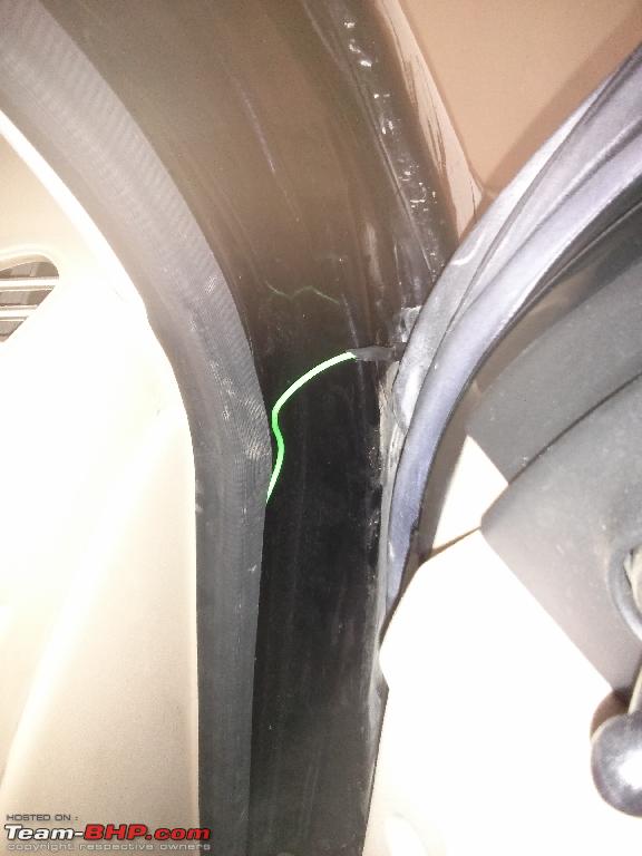

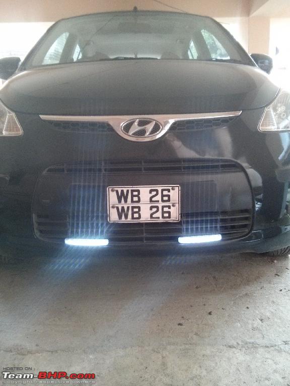

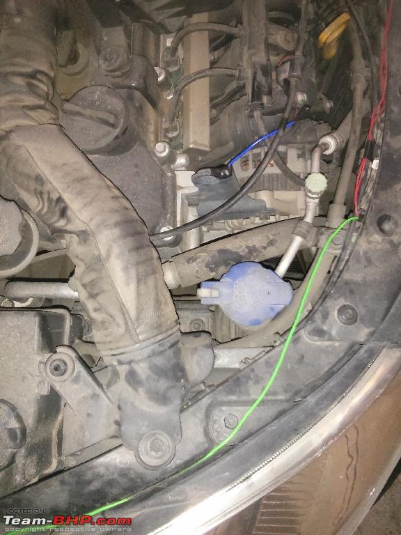

Well I could not find where the cig lighter wires are - everything is so densely packed in an i10!
What I did is I tapped the spare fuse slot for DRL (yes - i10 has a DRL fuse slot which is unused) with a spare 10A fuse, drew the wire in the engine bay through the door beading (again - could not find a way through the i10 firewall) to connect it with the DRL +ve, and grounded the -ve wire in the engine bay itself.
The DRLs come on when the key is at 'ON' position.
Sorry for the crummy cell phone pictures.

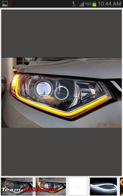

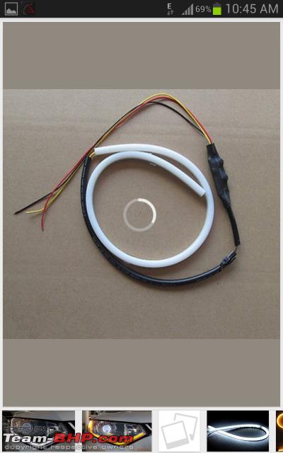

Please advice where can i get installed flexible DRL tube Dual mod, Day time / Turn Signal light in cochin. Like one in Audi and Porsche, For my Skoda Rapid's headlight.Any mod experts ?
Already sourced the product from ebay.in
Kindly adviced

I checked the post again. If you already have the DRL look for some local mechanic who knows the headlight job and self install the DRL if space is their using either superglue/hot glue or a double sided tape. If not, check the directory again. Bangalore has quite a few installers!
