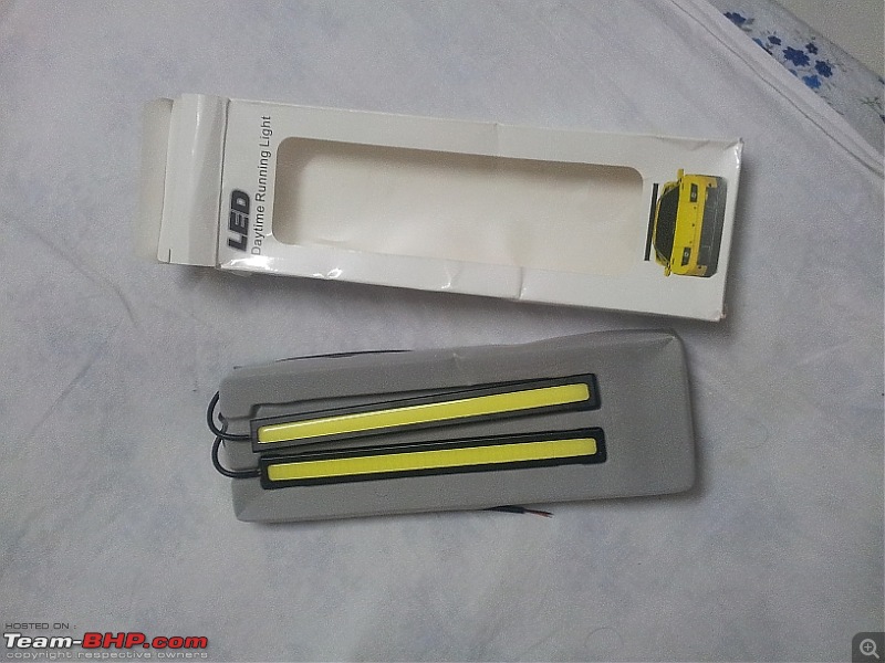

I recently bought Xenon White COB LED DRL Daytime Running Lights They are 100% Waterproof and give out 6000K light. Cost is Rs 615/-
The dimensions are 6.8 inches x 0.65 inches x 0.015 inches.
These DRLs are not flexible. The LEds are in a black colored aluminium casing. The casing can be installed using the provided 3M double sided tape.
These DRLs are super bright! I have yet to test them in day light but i am sure they are sufficiently bright for day time. I will post a video of that soon.
Meanwhile enjoy some pics of it. I have not fixed them permanently yet on my indica xeta glx. I am still collecting suggestions for the best possible position.
Check out the pictures and kindly suggest.
The DRL Thread: Everything about daytime running lights-20140206_210520.jpg
The DRL Thread: Everything about daytime running lights-20140206_211220.jpg
The DRL Thread: Everything about daytime running lights-20140206_184732.jpg
The DRL Thread: Everything about daytime running lights-20140206_184930.jpg

Would vote for the position in the first pic, on the bumpers.
Where did you source these from? Any idea regarding the reliability n life of the product??

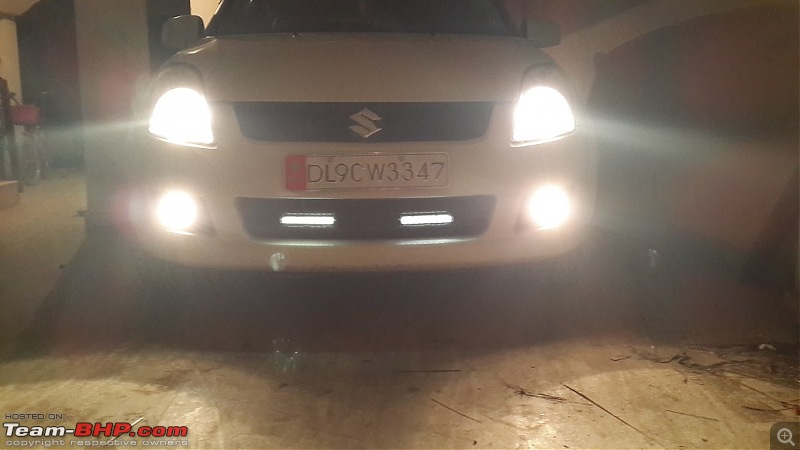

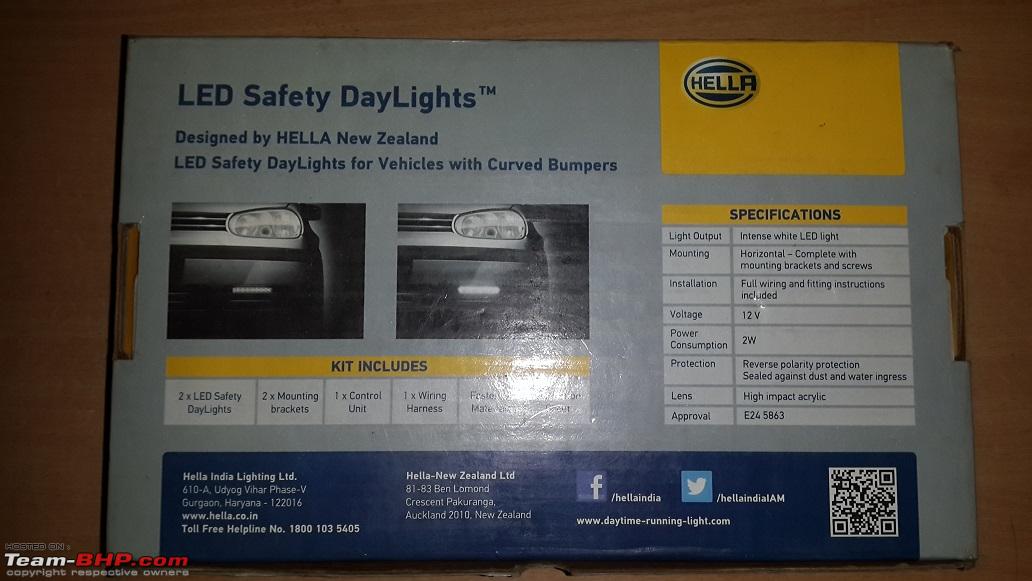

Got DRL's installed on my Swift
Product: Hella 8 Led Safety Lights with Day & Night Mode
Cost: INR 6700
Warranty: 5 Years
Installation: Day Mode connected to Ignition, Night Mode Connected to Parking lights.
Extra Fuse also added basis my request, otherwise its not needed.
Package
The DRL Thread: Everything about daytime running lights-box1.jpg
The DRL Thread: Everything about daytime running lights-box2.jpg

Night Mode
The DRL Thread: Everything about daytime running lights-night.jpg
Cost: INR 6700
Warranty: 5 Years
Are these installed on the slats on the air dam of the bumper? Does the light vibrate when engine is running?
LED's take up low power but are you facing any drop in RPM when using the DRLs?
Location of the extra fuse added?

Yes these have been installed on the air dam
The lights do not vibrate while the engine is running, as its tightly secured by the mount brackets and side clips.
No issues noticed with RPM
Extra fuse added to the wiring itself and secured adjacent to the fuse box.
