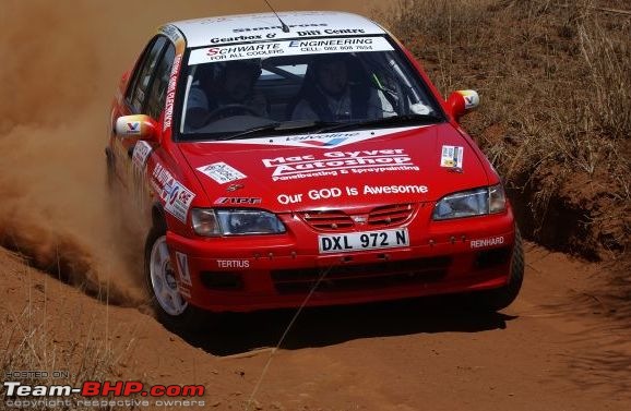

Sorry guys I dont agree, in my books the K&N filter is the biggest waist of money and bad to your engine. let me explain.
1. We tested the K&N Filter range on a high power rally vehicle where the airflow can make a huge difference. We did the test on a dyno meter, we ran the vehicle with Cone filters, flat filter and the standard paper filter. The K&N filter range did not give us a single extra kW - ZERO extra power!! The K&N makes the driver beleive his car performs better is due the increase indiction noise, the vehicle sounds fast... but is it really faster...??? NO ITS NOT
2. These K&N cone filter in the engine bay is BAD... BAD... BAD. If you look at the original design of a airfilter, one of the imporatant designs is to get fresh cool air from outside. With the filter under the bonnet, just behind the radiator is now getting a supply of very hot air.. which is bad for performance.
3. Then have a look at the density of the filter, what is the microns of the new oil soaked filter. K&N might let more air through, but the only way is to make bigger holes in the air filter thus more air and more dirt. A K&N filter is only good to filter the larger pieces or dust or rocks. The oil base air filter system has never being successfull.
Thus more dust/dirt into your engine will reduce your engine`s life... for just more noise?
Sorry guys, after our tests inthe Rally car we kept the original paper air filter, we just replaced the filter more often due to the very dusty condtions the vehicle was used in.+

The K&N Might have slight better airflow.
Do the following test, spray some oil in the intake pipe before and after your airfilter on the inside of the intake pipes, then go and drive very dusty roads - check after about 1000km the about of dust on the oil inside the pipes. You will find there is a lot of dust after the filter.
Sorry, but the extra airflow does not justify the larger dust peices going into the engine.

Your experience is a one off and therefore not representative. I by no means are in love with K&N. However as a human I give credit where credit is due.
The filter medium is very good. The cone applications are by far not the best.
When you put the cone filter in a hot spot then you hardly can blame K&N for it. Also, a stationary testing is of limited use.
If you have made your test on a standalone ECU without adapting the mapping tables then you can render your test useless. Every professional tuner should know this, but I know from long term experience that too many seem not to know.
Another important point is to place the cone filter in the right position for flow dynamic reasons, which has to points to it, which are minimal exposure to contamination and and least turbulence as well as highest possible pressure.
To master this is a fine art, which I am trying to master on a daily basis for longer than 3 decades. It is not as straight forward as it looks on a dyno test.
Rally applications have very little in common with all other applications and require measures accordingly. The cheapest way to deal with them is paper filters, but this is by no means the best application to get the best power output.
