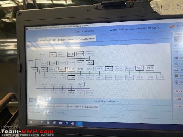

Guys! Any expert here in sorting or understanding how to solve this error code?
My horn is working perfectly fine, I have done VCDS adaptation some time back to do acoustic feedback while closing and opening through remote key and other good features as well.
Last week I saw this static error code during my ABS sensor replacement visit at the dealer. Technician told to ignore it as horn is working fine and there are no error codes on the instrument cluster.
I am not able to convince myself to ignore this, as it is troubling my mind thinking what the issue can be.

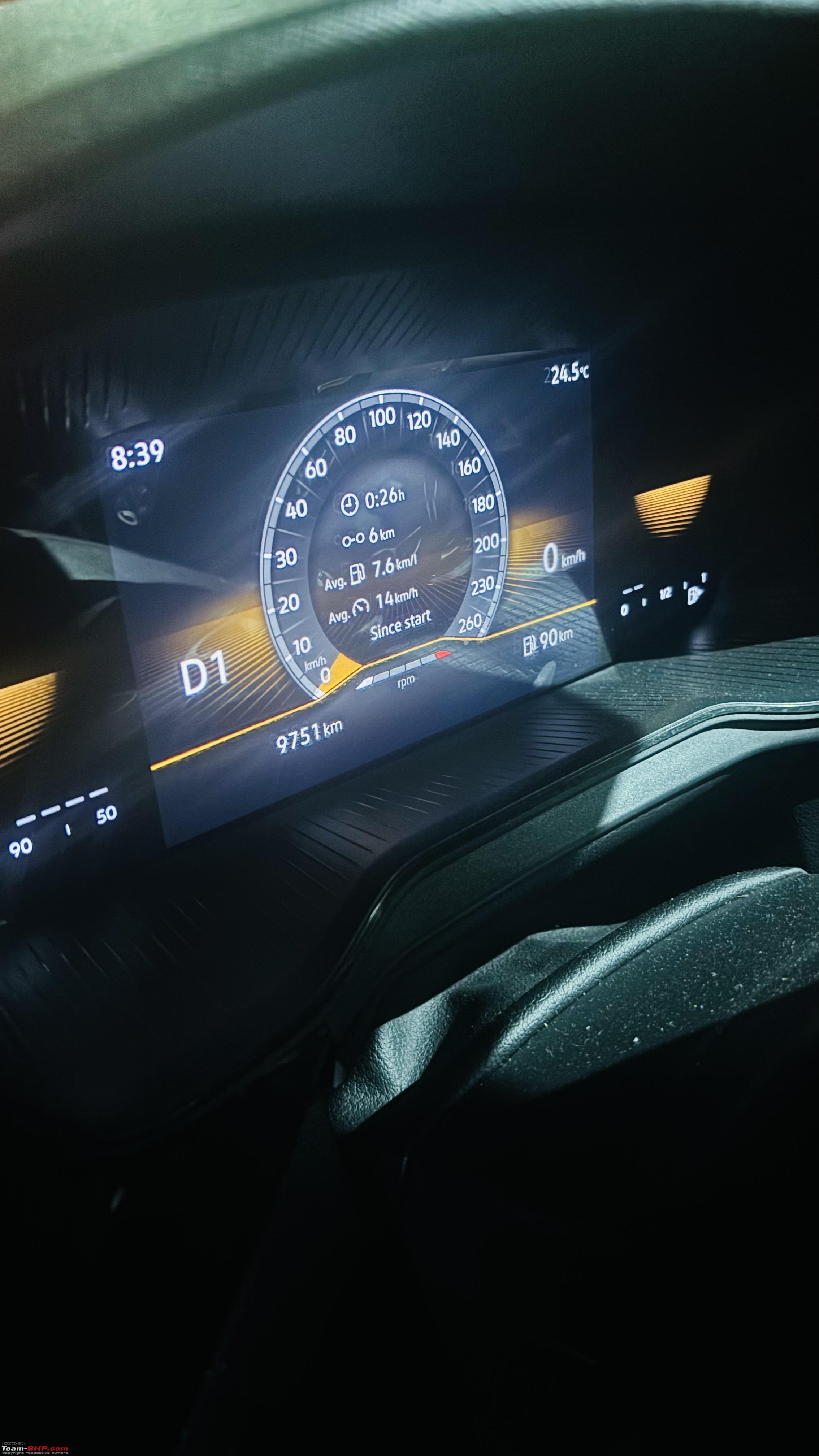

Anyone has managed to unlock a new version of rpm meter in Kushaq/Taigun/Virtus/Slavia? Attaching a picture of the same.
