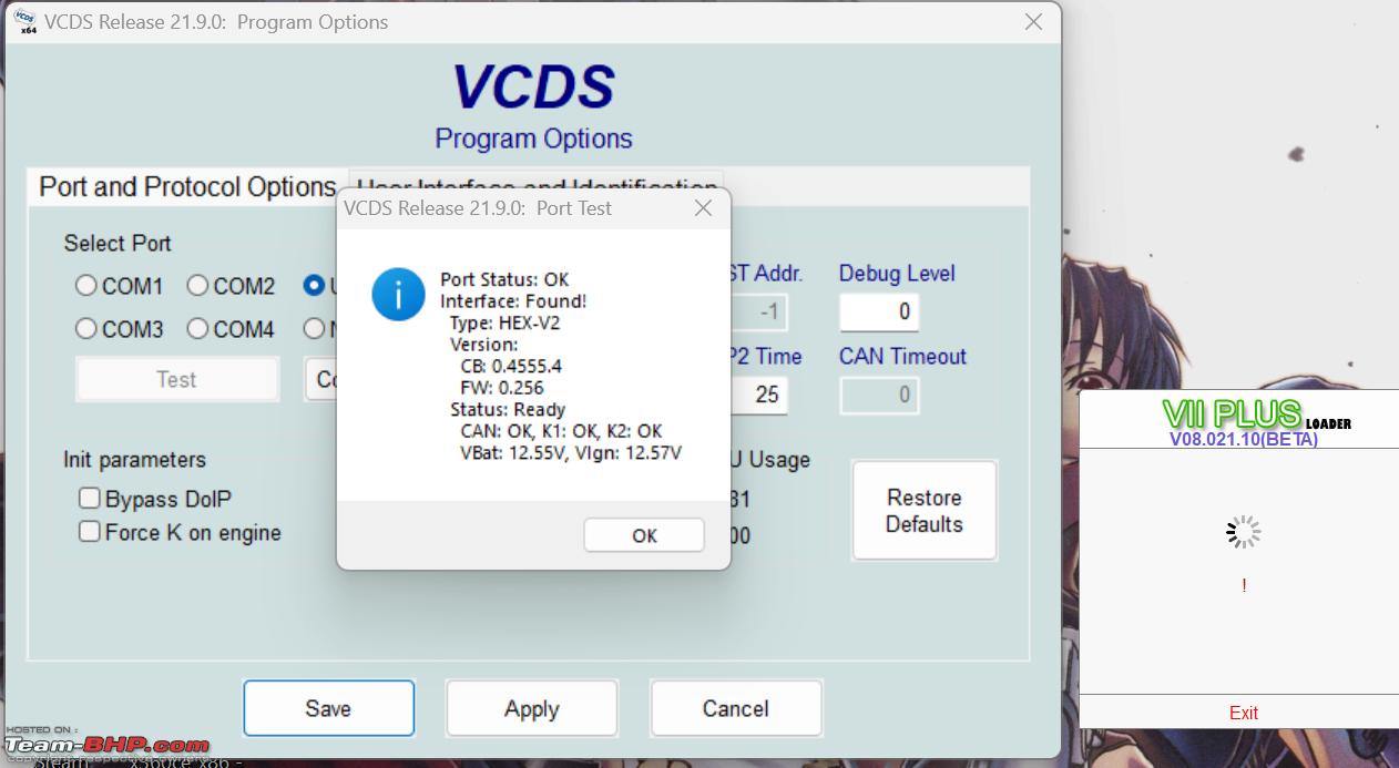

Got my car back from the detailing shop. I was so excited to do the HVAC tweak. However, facing a major setback.
The VCDS is throwing up an error "Unsupported Vehicle, Please make sure you are running a current version of VCDS"
https://www.team-bhp.com/forum/attac...1&d=1691334029
These are the steps that I followed,
1. As I got the cable from Motoscan, I followed through with them for the software, which they shared immedietely.
Files Provided:
VCDS-Release-21.9.0-Installer
VIIPlusLoader-08.021.10(BETA)-FULL-Installer
2. Installed the loader and vcds 21.9 while the real time virus protection was disabled.
3. The cable firmware was updated.
4. Dragged the VCDS icon on the desktop over to the loader. This opened the VCDS app.

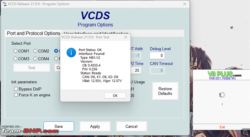

5. Ran the test thingy, Program Options - USB - Test. The test results were as follows while the cable was connected to the car.
https://www.team-bhp.com/forum/attac...1&d=1691334402
Now, I'm not sure what went wrong. I contacted Motoscan promptly. They spent a good 45 mins, re-installing and troubleshooting. They ended up getting the same error. They blamed it on the windows version that I was using. Apparently, it will work on windows 10 and requires some patch for windows 11 which I am finding it hard to believe. They had promised me to have it rectified by the following week.
As you had got the same cable and software version, I could really use some help with the setup. If it can work with kushaq, why not slavia? makes me wonder. Wondering if you had done anything differently from what I did. I really want this to work.
Also, if anyone from Chennai has a VCDS cable, I could use some help with the Auto HVAC Tweak while I get this sorted.

Old 6th August 2023, 22:51   #996
thirdmainroad's Avatar
Join Date: May 2019
Posts: 280
Thanked: 2,171 Times
Re: VCDS (Vag-Com Diagnostic System) for VW & Skoda - Discussion Thread
I’d try reinstalling the drivers, but via installing unsigned driver mode and trying again.
https://photobyte.org/installing-uns...dows-10-or-11/
I don’t have a VCDS, but have OBDEleven and will be happy to tweak your AC for you. I live on the ECR - Panaiyur though.
thirdmainroad is offline   (1) Thanks

Update VCDS version, I am currently using v23.3 and cable works perfectly on Slavia. I was having issues when I was on v21.9.

I'll try the unsigned driver Installation method today.
Thank you for the invite. I'll take you up on that offer. How do we meet? I got the email vcard in my profile.
What is the VII Plus loader version that you are using? The team from Motoscan did try updating the VCDS to v23.3. While the cable was connected through USB port and glowing blue, the VCDS app wanted to update the firmware of the cable.
If possible email me the loader and VCDS version provided with your cable. I believe this firmware update is done through the loader for cloned copies of the cable. I'm waiting for their team to try and troubleshoot this week before I attempt to deviate from the provided software version.
