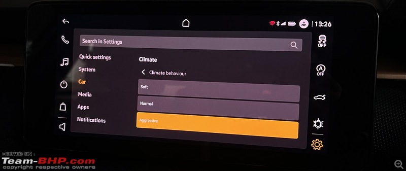

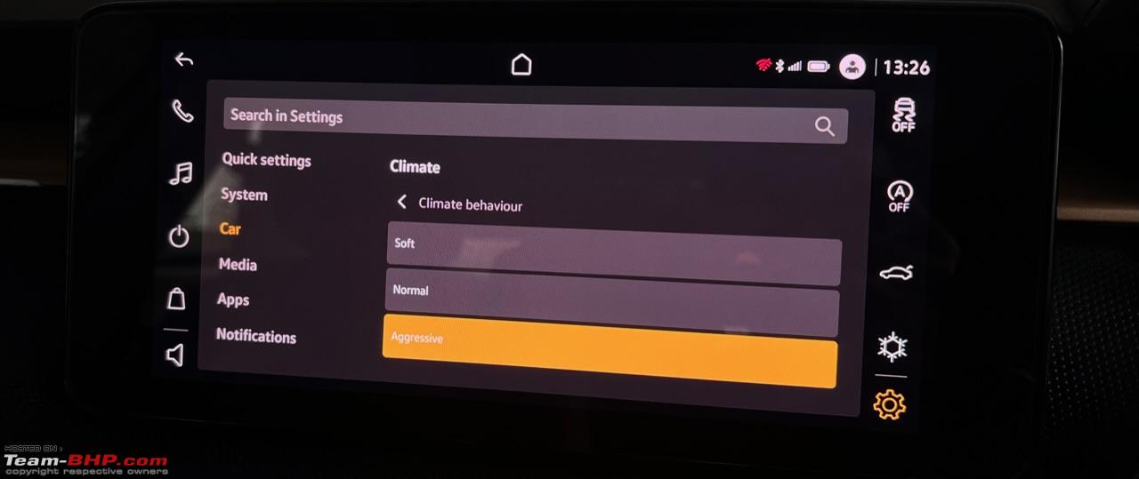

It's me who did those tweaks. AC tweak works in multiple ways including enabling an option in the infotainment to set AC cooling strength, and so does steering. In the power steering module I can change assistance curve as well as assistance levels from 0-100%. Both of it works. However sound tuning if changed the coding is accepted but no change.
Apart from that, for example in the Cluster I can see a bit for Lap counter which is accepted but no change.
You mean you've the AC config tweakable from the infotainment system directly without VCDS or that you tweaked it via the Radio Module instead of the Auto HVAC Module in VCDS?
Yes, but it cannot change the long coding but instead it temporarily overwrites the value and the AC behavior instantly changes
