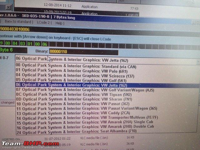

Originally Posted by Crazy_Bean View Post
Hi newtonMeter, as we had discussed some time back, I had recently swapped my car radio with a BOSCH RCD510.
Can you please tell how did you change the car from a hatch to sedan in VCDS. My car does not have OPS, but since the install of the Bosch unit. I have been noticing that the car image that pops up on my MFD (when we open the door) is a wagon. It used to be a sedan earlier.
I think somehow RCD 510 and my MFD are linked and fixing the car in the RCD 510 should fix the MFD display. Thanks
You will find it in the RCD 510 menu (RADIO menu) i think channel 55. ill check it today and let you know.
Do VW service centers have the capability to RESTORE the VCDS settings for all the modules with one click to Factory settings?
I think I have fiddled too much with VCDS and feel the need to just restore everything as my annual service is due soon.
I do have VCDS scans of my car (Initial) but still would prefer the factory reset. Possible?
Also I came across a weird fault code. Does any one have any background on this. Thanks.

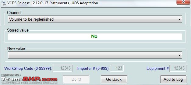

re: VCDS (Vag-Com Diagnostic System) for VW & Skoda - Discussion Thread
Enabling Refuel quantity to be displayed in the MFD:
Go to 09 - Central Electronics:
Then, Adaptation - 10:
In the Channel drop down list, select Volume to be replenished. The default option would be No:
In the New Value drop down list, select Yes:
Do it! and exit out of the windows.

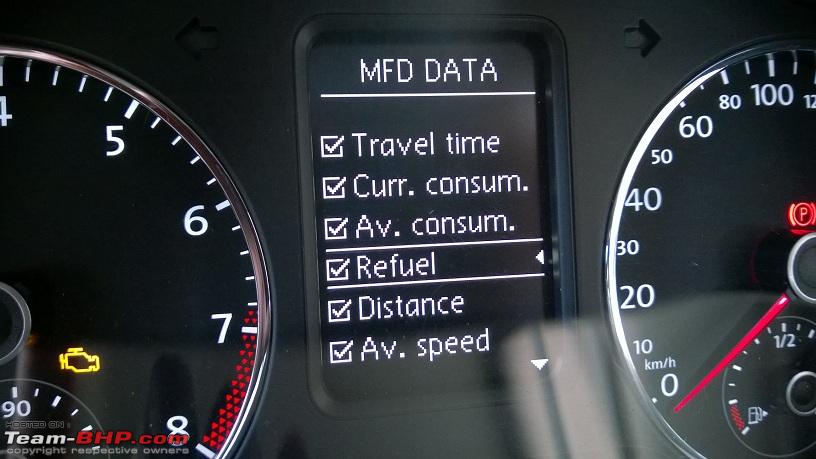

Head to the MFD’s main menu and select Settings:
VCDS (Vag-Com Diagnostic System) for VW & Skoda - Discussion Thread-wp_20150305_11_36_09_pro.jpg
Select MFD Data:
VCDS (Vag-Com Diagnostic System) for VW & Skoda - Discussion Thread-wp_20150305_11_36_27_pro.jpg
Enable Refuel checkbox:
VCDS (Vag-Com Diagnostic System) for VW & Skoda - Discussion Thread-wp_20150305_11_36_56_pro.jpg
Exit out of the menu and cycle through the several functions. We get this:
VCDS (Vag-Com Diagnostic System) for VW & Skoda - Discussion Thread-wp_20150305_11_37_44_pro.jpg
The quantity displayed is approximate and it varies in units of 5.
The Jetta and Passat’s cluster can display this function. Not sure about the current gen. Polo/Vento. Owners may try and report.
