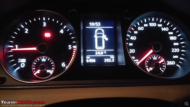

Hi, I recently acquired my VCDS cable from Aliexpress. It was my first time with the cable, so obviously at the first attempt, it did not work. I then realized that the ignition needs to be on and all doors unlocked. Anyway, I got it working.
Executed some basic mods on my Passat like - removing seat belt chime, tear wipe, ABS brake light flashing etc.
Have been struggling with a few bits, Realized it was Team Bhp time. I need help with the following bits:
1. I don't know what i did, but now in my MFD, I see a Wagon (or Hatchback) in the door opening sign. (Pic attached)
I cant seem to figure out how to revert to the Saloon info graphic that i had previously.
2. I want to activate indirect TPMS. I think its called 7k6. Its pretty straight forward in Golfs but I am not able to figure it out on my passat.
3. About the seat belt chime, i have altogether removed the seat belt indicator and chime (Using Long coding helper). I would like it if someone could help me with enabling the seat belt indicator and removing the chime only.
4. If I select Alt Speed in the MFD menu, i see speed in mph format, whereas on the speed screen its kph, can the minimized alt. speed view be modified to display kph. (place where you see 24.0 C in the image below)
Many thanks

I was trying to figure out from the pic, which hatchback in India has those dials (before I read it's your Passat)!!
Regarding your queries,
1. You must have accidently changed the vehicle model from the drop down list or activated the car outline as Wagon in long coding helper of 17-instruments module?
2. For enabling indirect TPMS, you would have to select "TPMS installed/active" (something similar) in the 03-ABS Brakes module. IIRC you need to enable it in 17-Instruments module too for the warning lamp indication. Once enabled, it takes some few mins or may be an hour of driving to learn/adapt.
3. I think seat belt chime and indication lamp comes under seat belt warning activating option in which case it might not be possible to turn off the chime alone.
4. Mine also shows speed in "mph" at the bottom if i enable alt. speed display. Haven't checked how to change this. Should try some time.
