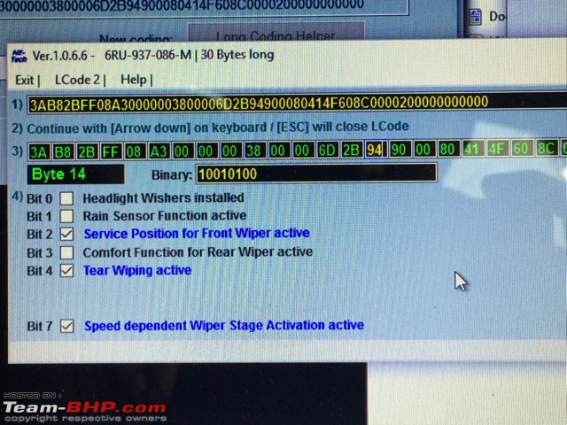

thanks Gannu, another thing I'm confused with, I activated the rear comfort wipe on my friends GT ( bought Feb 2015) and it worked! Doesn't work on mine ( Oct 2015). This was done using a 12.12. Apart from that I was able to activate most of the other things for both cars, and also the park volume didnt work in the other car as well ( tried it as I thought his might be an older version since the rear comfort wipe worked in his car).
So, I also tried changing the value to 1 from 0 for the comfort wipe and tested - which came back with a value 0. Siigghhh.
P.s : the tear wipe works fine.

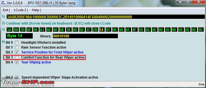

How did you enable rear comfort wiping? There are 2 ways to do this:
1. Through BCM long coding, Byte 14:

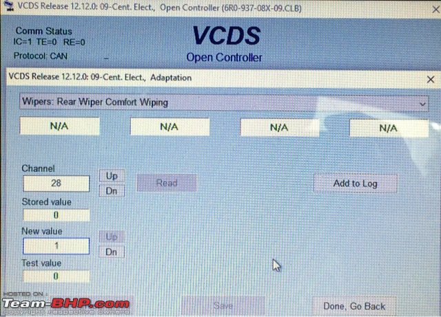

2. The other one is through Adaptation:
Try this.
Attachment 1445433
Try this.
I tried both the methods, did a roll back of the 16 dig long code and tried again as well. This is what I get.
VCDS (Vag-Com Diagnostic System) for VW & Skoda - Discussion Thread-imageuploadedbyteambhp1448853728.412884.jpg
And it unchecked again when I went in again

I tried this also via adaptation with no avail, Could it be because it's the 12.12.0?
VCDS (Vag-Com Diagnostic System) for VW & Skoda - Discussion Thread-imageuploadedbyteambhp1448853838.639229.jpg

But wait your BCM is 086 M? Man, WTH is wrong with VW! I thought they were using the highline 087 R BCMs for the GTs now. Even a friend's Polo Highline diesel has a highline BCM and he had cruise control installed recently. This is atrocity!
