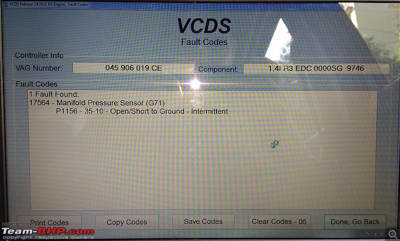

Check Engine light came up on the instrument cluster the other day, so in the evening, i thought of checking and clearing the fault if possible. This is what my car was diagnosed with -
Fault with MAP sensor
VCDS (Vag-Com Diagnostic System) for VW & Skoda - Discussion Thread-img_20151224_104336.jpgVCDS (Vag-Com Diagnostic System) for VW & Skoda - Discussion Thread-img_20151224_104425.jpg
This remains there for a day and goes away. Its been happening for some time now.

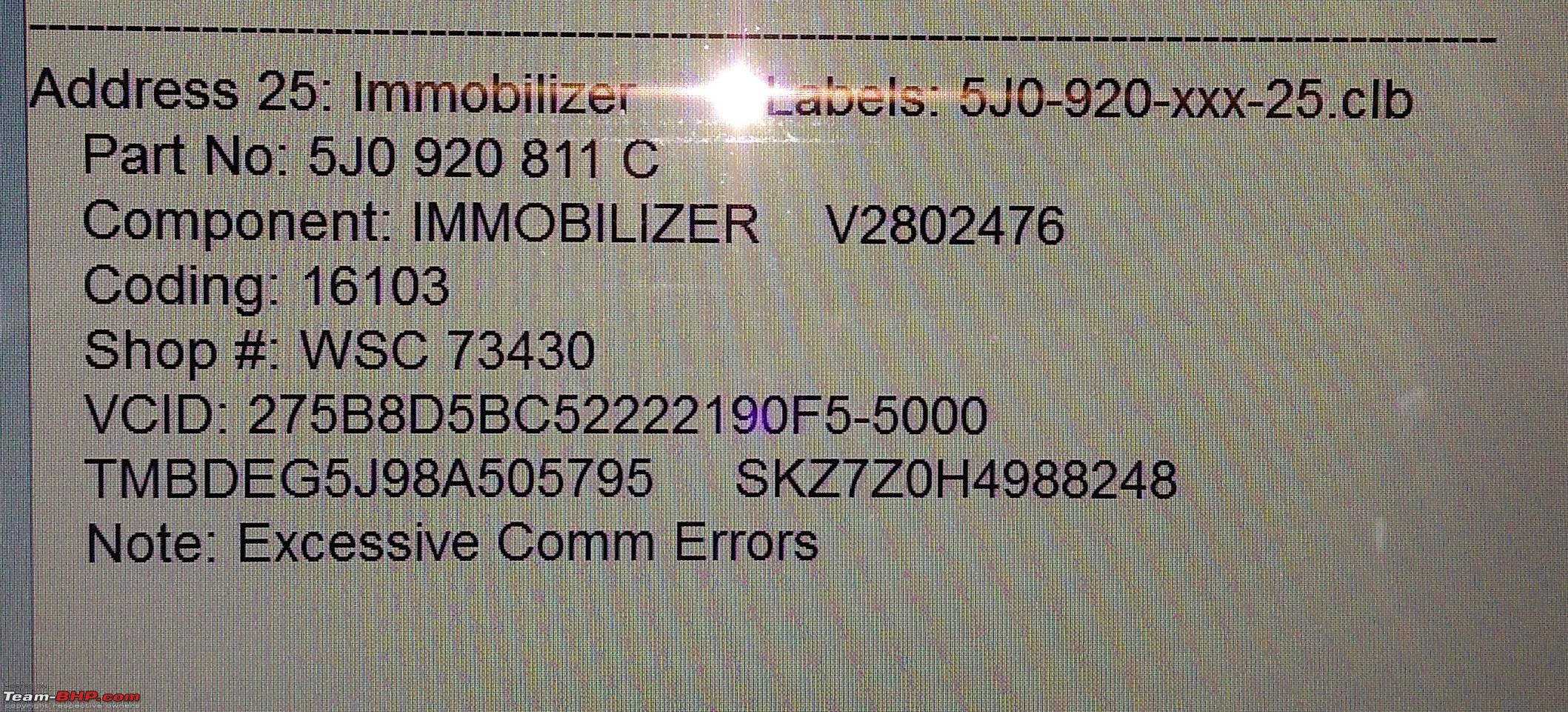

Immobilizer error
VCDS (Vag-Com Diagnostic System) for VW & Skoda - Discussion Thread-img_20151224_104508.jpg
Tried DTC to clear all fault codes, but this still remains. Not that there is any error when i check specifically for immobilizer, but it stops auto scan and says "excessive com errors"

Most MAP sensor errors can just go away by cleaning the sensor rather than replacing it. A nice DIY -
Also refer to ajmat's thread to clean the MAF sensor - http://www.team-bhp.com/forum/diy-do...-rs-120-a.html

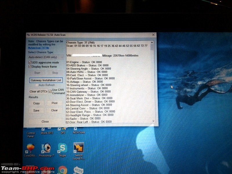

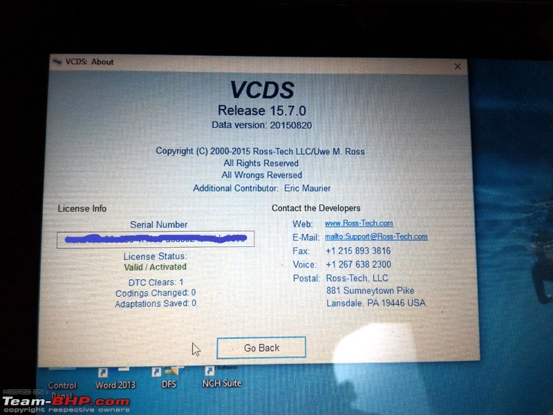

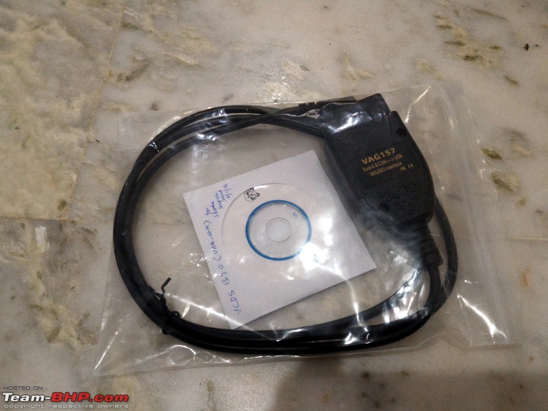

Received my VCDS Vag-Com cable today through Aliexpress (link already posted earlier). It is 15.7.0 version as promised by the seller and build quality is excellent. Has a green led light also (on the underside when connected) which lights up when properly connected. Complete tracking was provided by the seller and I could also track it by India Post Tracking. No customs was charged.

Software was installed as per instructions in the cd and was activated.

Initial scan was done. Please switch ignition key to on in the car before running the first test of the cable. The 1st scan threw a ABS error!! Went into the error and found that it was the TPMS error on the date that I had my punture...lolz. Cleared the error and ran a rescan. No errors.
VCDS (Vag-Com Diagnostic System) for VW & Skoda - Discussion Thread-vcds-vagcom-15.7.0_3.jpg
A well spent Rs. 1575/- I would say. Now the possibilities are open to experiment and any suggestions are most welcome.

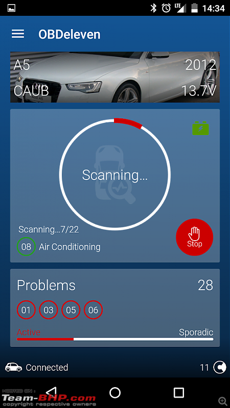

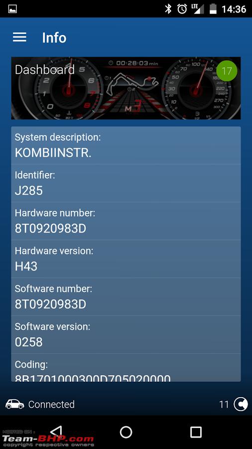

I just joined Team-BHP and this is my first post. I am quite excited to share the new VCDS tool that I got from http://obdeleven.com/
Got the delivery couple of weeks ago and I am able to do everything that has been discussed here.
It is pretty handy as it just required the dongle and any android phone. The best part is their support. They are willing to add any custom application that we want. They do not support apps for the India Polo as of now.
Ofcourse the price is unbeatable.

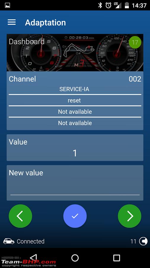

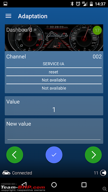

Here are some screenshots from the Playstore.

Do you get long coding help like is Ross tech

Good point. No they do not have long coding helper as of now. They have the adapatations helper in place for Instrument Cluster, BCM, ABS etc.
What I do is look up the forums to find the right byte and bit for each function and change the settings.
If there are settings you frequently change and want to have an app for it, you can request the OBDeleven guys and they will create an app for it.
