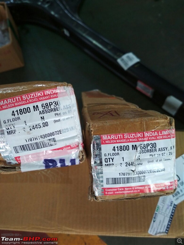

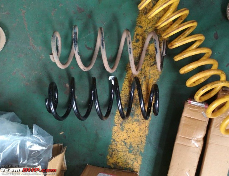

05/10/2017 : Full Suspension kit Replaced under Warranty!!
Maruti Baleno: Full suspension replaced under warranty!-img20171005wa0008.jpg
Maruti Baleno: Full suspension replaced under warranty!-img20171005wa0010.jpg
Maruti Baleno: Full suspension replaced under warranty!-img20171005wa0009.jpg
Maruti Baleno: Full suspension replaced under warranty!-img20171005wa0006.jpg
Maruti Baleno: Full suspension replaced under warranty!-img20171005wa0023.jpg
Maruti Baleno: Full suspension replaced under warranty!-img_20171005_144938.jpg
Maruti Baleno: Full suspension replaced under warranty!-img_20171005_144848.jpg
Maruti Baleno: Full suspension replaced under warranty!-img_20171005_151834.jpg
Maruti Baleno: Full suspension replaced under warranty!-img20171005wa0027.jpg
Maruti Baleno: Full suspension replaced under warranty!-img_20171005_190917.jpg
There are no major visible differences between new and old parts. The rear shocks felt little softer on inspection and rear coils were around 1cm shorter. There was very minor change in new rear suspension beam. The place at which the coil springs are seated has minor difference. It took around 4 hours to replace the full suspension.

1. The suspension setup in Baleno is not defective. There is no noise, oil leaks etc and Maruti is not bound to recall the cars.
2. All Manufacturers keep improving the parts based on domestic feedback. Maruti has also done the same and slightly changed the design in 2017 models for better ride quality.
3. I appreciate Maruti Suzuki for listening to pre 2017 customers and replacing the suspension under warranty.
4. I do not advice everyone to get it replaced. If the ride quality is very bouncy and the owners genuinely feel the need for change.. Go ahead!!
5. Do not expect day and night difference with new suspension. The ride would be still on stiffer side but not so stiff as before.
