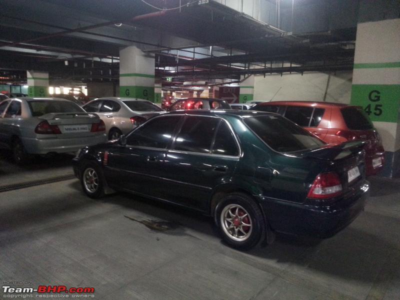

Hello All, this is my OHC! Just clicked the pic at inorbit mall, vashi!
Update : it's been 5 days on sequential CNG now and I m enjoying it, the car does an average of 80 kms everyday. And it's giving me 16-17 km per kg within city- performance wise it's about 10% less especially when I want to really race quick. In normal driving conditions there is hardly any difference.
Other things : it's a lovato kit. Takes 10kg gas at most, costed 52k with all rto work.
The car before adding CNG used to idle at 650rpm. When you put the A.C. on it goes upto 700rpm . This my CNG installers said needs to be tuned and with it the performance on CNG will also go up. Can someone suggest where to get the timings adjusted and tuned to perfection?
On a side note, in sequential kits the CNG ECU simply copies whatever is the program on original ECU.
Looking forward to your comments on this thanks
