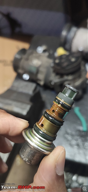

Update: got the refrigerant control valve of the compressor replaced at a local mechanic.
Result: made no difference to the intermittent operation of the compressor. Still blows freezing cold air for a while then normal air. Restarting AC gives freezing cold air again.
Next step is to get the compressor replaced. I have a doubt regarding this; compressor wasn't filled with gunk or any black mess. Should I get just the compressor replaced or the entire AC system?
Here's the valve that was replaced.

Are you sure the cooling coil is in good condition?
Then test the entire system for leaks that might cause icing up or moisture buildup. Injecting refrigerant with a dye and checking for colour might show this up.
Then check the compressor clutch, piston, expansion valve (which you changed right) etc see if that can be serviced instead of the whole thing.

No symptoms of frozen cooling coil. Cabin filter has always been replaced religiously. Air flow is always normal. Just a simple on/off of the AC fixes the cooling, so it can't possibly be a frozen coil.
The valve that was changed was refrigerant control valve. Mechanic man said expansion valve and clutch is fine and that there are no leaks in the system. (Compressor was removed and RCV replaced on it and the entire system was inspected, except what's under the dashboard)
I feel it's something electronic that's asking the compressor to cycle on and off. How do I go about checking the cabin temperature sensor?
