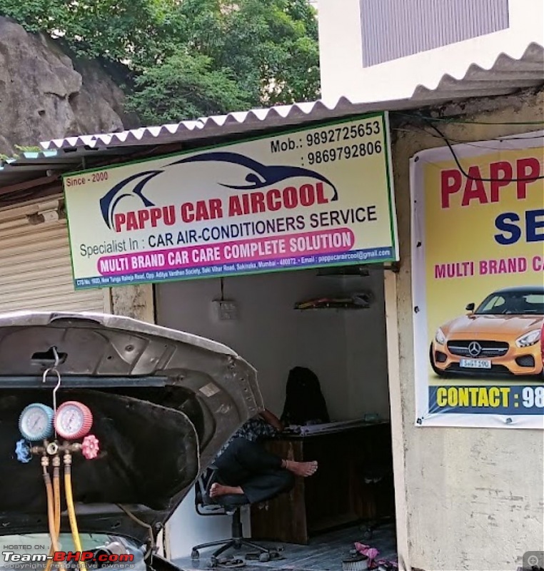

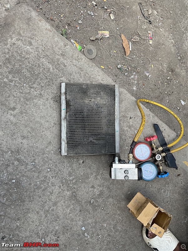

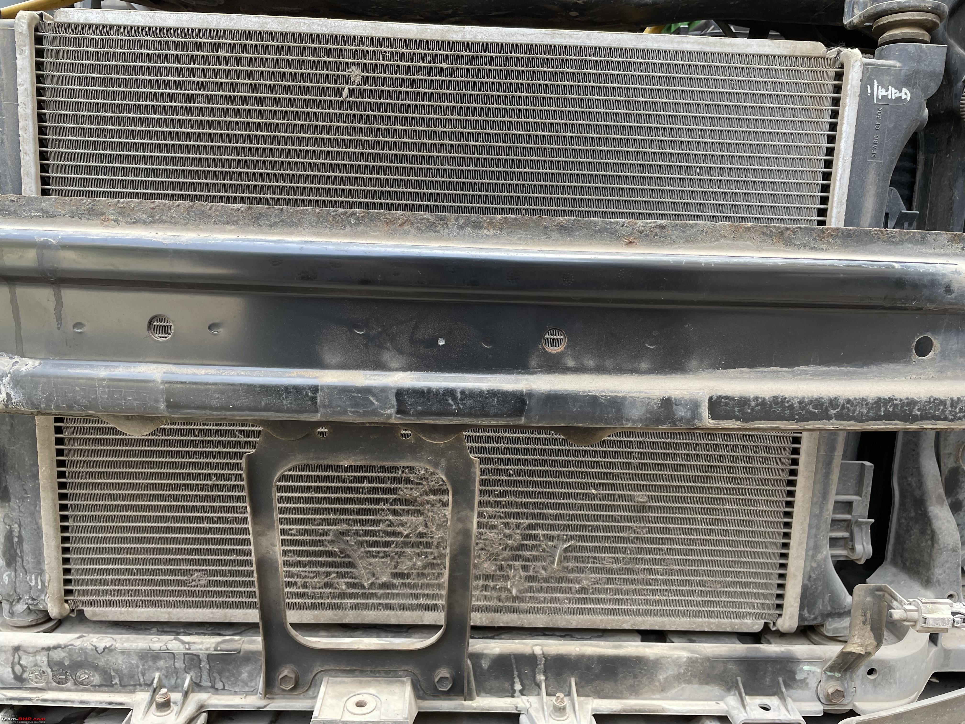

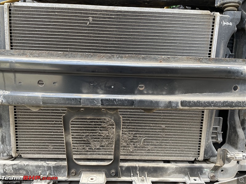

I have managed to get my i20 AC repaired. The work was done at a nearby mechanic by the name of Pappu Car Air Cool. The work was done by two mechanics. Leaks were found in the pipeline and in the condenser coil located behind the dash board. Thorough cleaning was done of the radiator mesh as well. I have attached some pictures below. The compressor oil was topped up. Total cost ₹9000.
