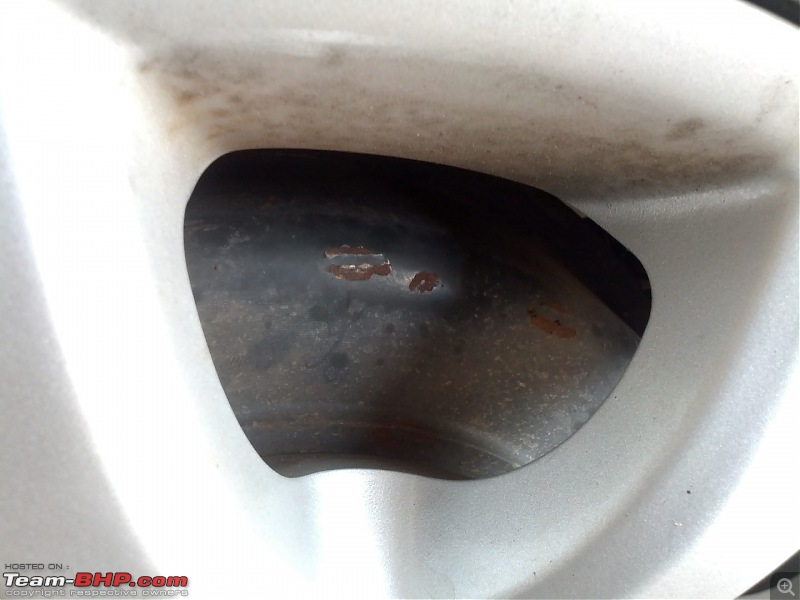

Have anyone experienced rusting on the rear wheel brake drums? I have done 3M underbody rust prevention/coating but this part is not covered! Any recommendations to treat these parts? I have seen folks painting just that brake drum in a distinct color, looks good too.
My 9 year old Fiat Palio never had rusting on brake drums!

Originally Posted by sgmitr13 View Post
Have anyone experienced rusting on the rear wheel brake drums? ...
Of course! They are steel and they will eventually rust!
We of the old Landmaster and Ambassador days have seen it often!
You need to have protection coatings applied after due diligence, ie stripping off the old coatings and thorough cleaning.
