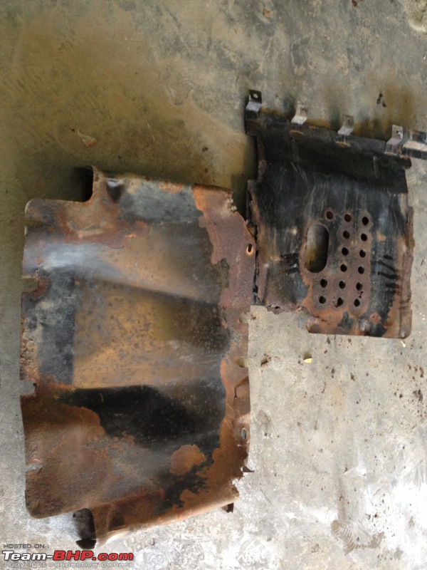

Old 9th March 2013, 12:10   #5035
Lukeskywalker's Avatar
Join Date: Feb 2006
Posts: 1,396
Thanked: 1,244 Times
Originally Posted by Prowler View Post
Luke - You say both the shields. I lost my shield that lives directly under the engine (engine shield). What is the other shield you replaced ?
The underbody shields consist of two pieces, one with holes is fixed under the engine, the other is fixed further back under the transmission.
The Tata Safari 2.2L Technical / Problems Thread-image3767630442.jpg
The older ones which were removed may give a better idea
The Tata Safari 2.2L Technical / Problems Thread-image3025969617.jpg
