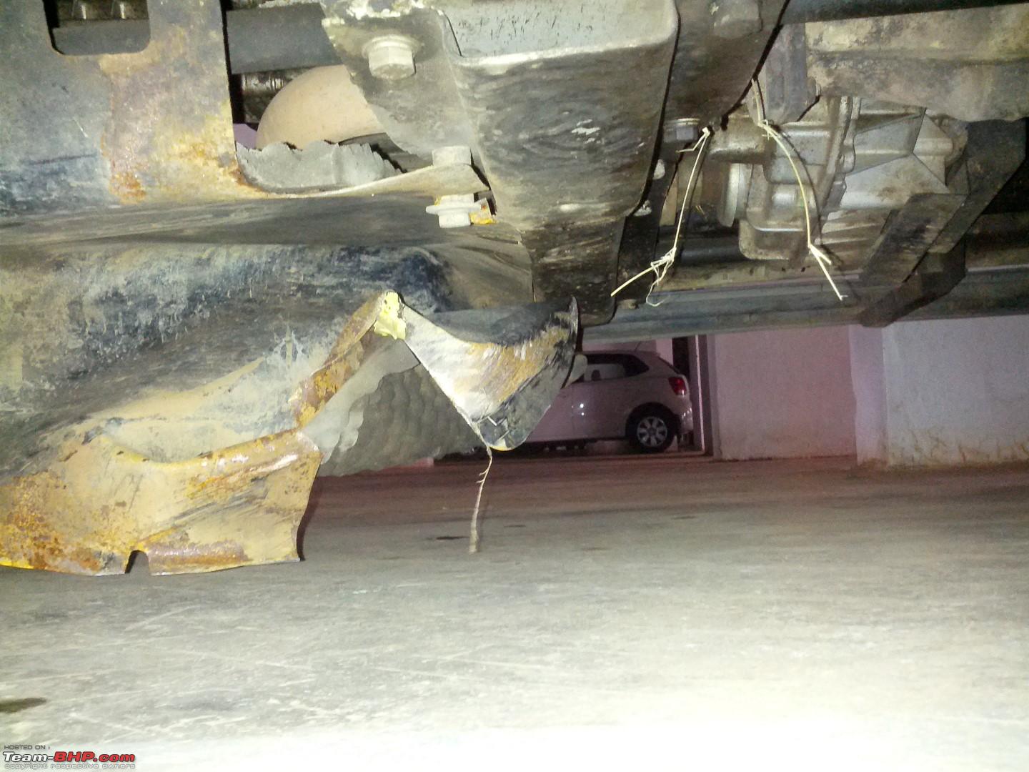

Vehicle returned from 5th service @ 44500KMs and I'm horrified to realize the scraping and falling parts when going over the small plastic road bumps inside our apartment complex
I suspect loose nuts & bolts.
This is from Concorde Begur Road, and looks like the driver who delivered the vehicle knew it and quietly left the car or he didn't realize the damage.

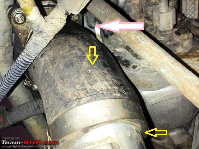

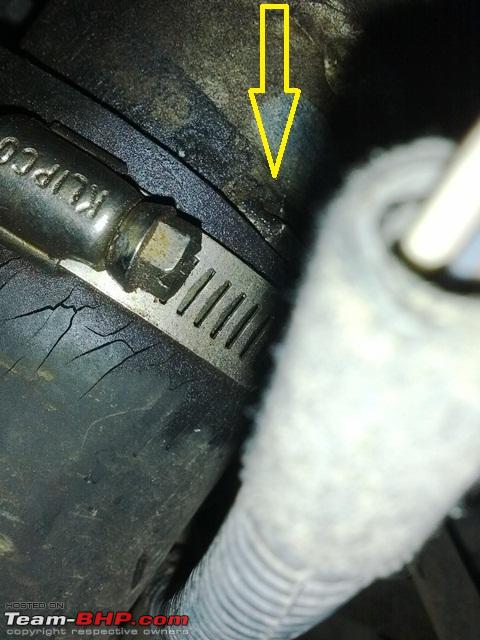

Symptoms: Sudden loss of power, but no thick black smoke. Max speed 90kmph Feels like driving my old 2003 Indica. Pedal to metal no respite.
Time: Afternoon 3pm
First I thought bad quality of diesel and drained the fuel filter and fuel sedimenter. But no effect a little better 5% maybe.
Casually chatted with fellow bhpian jaysmokeleaves and he immedietly said that it was a classic symptom of blown turbo hose or similar. Was told to check all hoses and tighten up the screws. Special attention to be made to the turbo hose (black in color) near the intake manifold on the left side of the vehicle.
I still donot know the extent of the damage yet, but let the pictures talk taken this morning.
The Tata Safari 2.2L Technical / Problems Thread-turbo1.jpg
I felt the hose pipe and it was reecing oil all over. But wait there was something rubbing it also from the engine side. There is no gap. (marked with Pink Marker in the pic below.)
The Tata Safari 2.2L Technical / Problems Thread-turbo2.jpg
My question is that is this a classic design failure? Has TML come-up with redesigned turbo hose or what?
The good news is that this circus happened sooner than during the upcoming trip. The vehicle had been for service a little earlier and I had specifically asked them to check for all the hoses and replace if necessary.
Someone didnt do their job and thats what stenches big time.
Rahulk76 is offline   (3) Thanks

Originally Posted by Rahulk76 View Post
Casually chatted with fellow bhpian jaysmokeleaves and he immediately said that it was a classic symptom of blown turbo hose or similar. Was told to check all hoses and tighten up the screws. Special attention to be made to the turbo hose (black in color) near the intake manifold on the left side of the vehicle.
I still don't know the extent of the damage yet, but let the pictures talk taken this morning.
Someone didn't do their job and thats what stenches big time.
Woah, pretty bad situation there with the hose. Seems like the problem didnt happen suddenly, but developed over time and glad it happens before your trip.
I am wondering why did not the TASS identify the problem of the hose when were told to ?
Please let us know about the outcome of the resolution and also check if Tata has redesigned the hose to avoid rubbing?

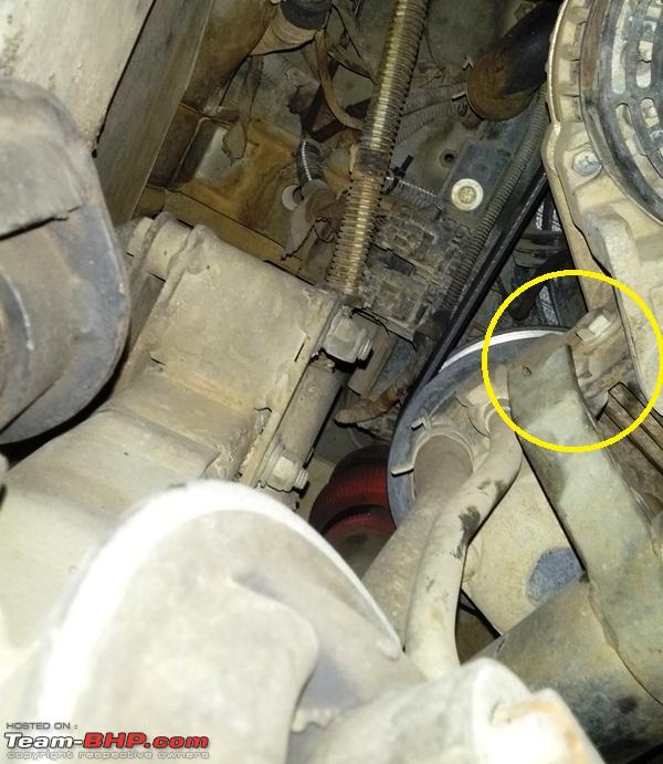

Attachment 1091866
Hi
I was getting my car serviced at TASS and saw the similar case as in your safari.
There is a bracket attached to the iron pipe (which connects to the intake manifold) which is attached to powersteering pump. That bracket generally breaks off therefore letting that pipe loose. Due to vibrations etc that iron pipe makes a racket inside the engine bay and therefore leads to the hose coming off.
Can you please check if indeed your intercooler to manifold pipe is intact and held securely at the bracket. As i saw it was near the bottom towards the intercooler (red color small silicon hose)?
Tx.
roadjourno is offline   (1) Thanks
Old 5th June 2013, 20:00   #5172
Rahulk76's Avatar
Join Date: Sep 2005
Posts: 1,148
Thanked: 235 Times
re: The Tata Safari 2.2L Technical / Problems Thread
Originally Posted by roadjourno View Post
There is a bracket attached to the iron pipe (which connects to the intake manifold) which is attached to power-steering pump. That bracket generally breaks off therefore letting that pipe loose. Due to vibrations etc that iron pipe makes a racket inside the engine bay and therefore leads to the hose coming off.
Well thats it ! a similar story here. The bracket broke. I dont know since how long.
Its a bad design. Real bad design. Somebody didn't do the proper Finite Element Analysis of this bracket. Kudos to the engineer who designed & tested it
Ill let the picture speak for itself. See how much play is generated due to it.
The Tata Safari 2.2L Technical / Problems Thread-turbo-break.jpg
The pipe costs 4xx. The rubber hose costs 3xx something and the labour to do it 600 .
The pipe has been ordered, and should land in a FEW days in Pune. (Shipping from Pune-Pune) beat that.

Can you please share a high level picture of where this pipe is located. I would like to check in my car also. With the present pics, i am confused, where the exact location is of this pipe.. Thanks in advance.
This is on the left side of vehicle Ankur. (Where the oil filter is present)
The above pic is taken by placing the phone camera facing towards front side of the vehicle, placed on the Oil Filter of Safari in the engine bay.
Hope that helps.
