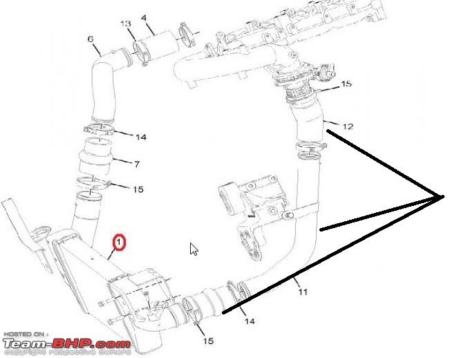

Originally Posted by Rahulk76 View Post
Well thats it ! a similar story here. The bracket broke. I dont know since how long.
Its a bad design. Real bad design. Somebody didn't do the proper Finite Element Analysis of this bracket. Kudos to the engineer who designed & tested it
Ill let the picture speak for itself. See how much play is generated due to it.
Attachment 1093367
The pipe costs 4xx. The rubber hose costs 3xx something and the labour to do it 600 .
The pipe has been ordered, and should land in a FEW days in Pune. (Shipping from Pune-Pune) beat that.
Finally the pipe didnt come to TASS even via order so started frantic search by calling all the TASS with the part number.
Located one TASS Pandit Auto at Sahakar Nagar who had only 1 piece. Its a very slow moving part. Requested him to book it for me.
Went there and got the stuff installed. To my dismay one more red small silicon hose connecting Inter-cooler to this pipe was cracked from outside. Got it replaced too.
Checked the the pipe for leak etc none found. Safari has become more silent and i can see the boost going uptil 14psi on the torque app. Not sure if its right or what but vehicle feels tighter than before.
Let the pic do the talking.
The Tata Safari 2.2L Technical / Problems Thread-tbhp.jpg
Schematics
The Tata Safari 2.2L Technical / Problems Thread-tbhp-icpipe.jpg
Cheers !
Can you please share the part no of 12 pipe. In my car it is also leaking, and my local parts guy either wants the complete pipe or its number to make the order to the supplier.
