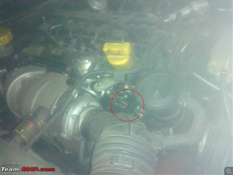

Thanks for the responses. My friend managed to take pictures of the area in the engine bay where he saw the oil leak. Apologies for the poor quality of the picture taken on mobile. Hope it helps to have an idea about the location that we are talking about. Please note that he cleaned the oil spill with a cotton cloth before taking the pictures for better clarity.
The update is that he is planning to visit TASS again; this time with the determination to encourage the gentlemen over there to fix the issue permanently

Looks like turbo oil return line. Part costs about 450/- and labour about 300/- at TASS. New pipe they fit has a better design. Mine had that leak too. It was slow 1 or 2 drops overnight after driving.
-BJ

Thanks bj96 for the response. The vehicle is in Prerana B'lore workshop now - as I have been having good experience with them last 5+ years in servicing my Safari, I sent him there.
I have informed my friend about all the information collected via my post at this forum. My friend is following up with the workshop very closely this time, so we would have a feedback if the real issue is identified and fixed.
