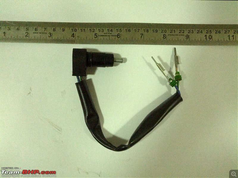

Took it to TASS Hosur Road, Bangalore.
1) No loose connections anywhere, both underneath the driver seat and under the chassis.
2) ECU is fine, so they are suspecting problems with the Sensors.
3) Transfer case ECU has no scanners, the error codes are determined using Blink Code method; kind of binary output using the LED light illumination. There are about 6 different codes totally.
I was asked to bring the vehicle back on Friday as they don't have spares sensors and I wonder how they would get it in 3 business days.
For now driving around AS IS :(
After a trial and error method, TASS guys narrowed the problem to Speed Sensor in 4x4 gear box. I suspect it is due to a recent under-body wash or being an electrical component it gave away (short circuit?).
As for the cost .. it costs a bomb ... damn Rs.3000
Buddy is still with TASS for the last 4 days :(
This little fellow is the "speed sensor" and costed Rs.3060.
Labor to detect and replace Rs.1034. All costs includes taxes.
If anyone is pondering .. no none in that spins, its one single solid piece.
With a single digit margin and tough competition in the auto sector, companies make money from such spare parts sale.
... companies make money from such spare parts sale.
Safari transfer case and 4x4 ECU is imported (from Borg Warner). Very likely this sensor is imported too, translates to about $50/- including import duty and other taxes... looks about right.
-BJ
