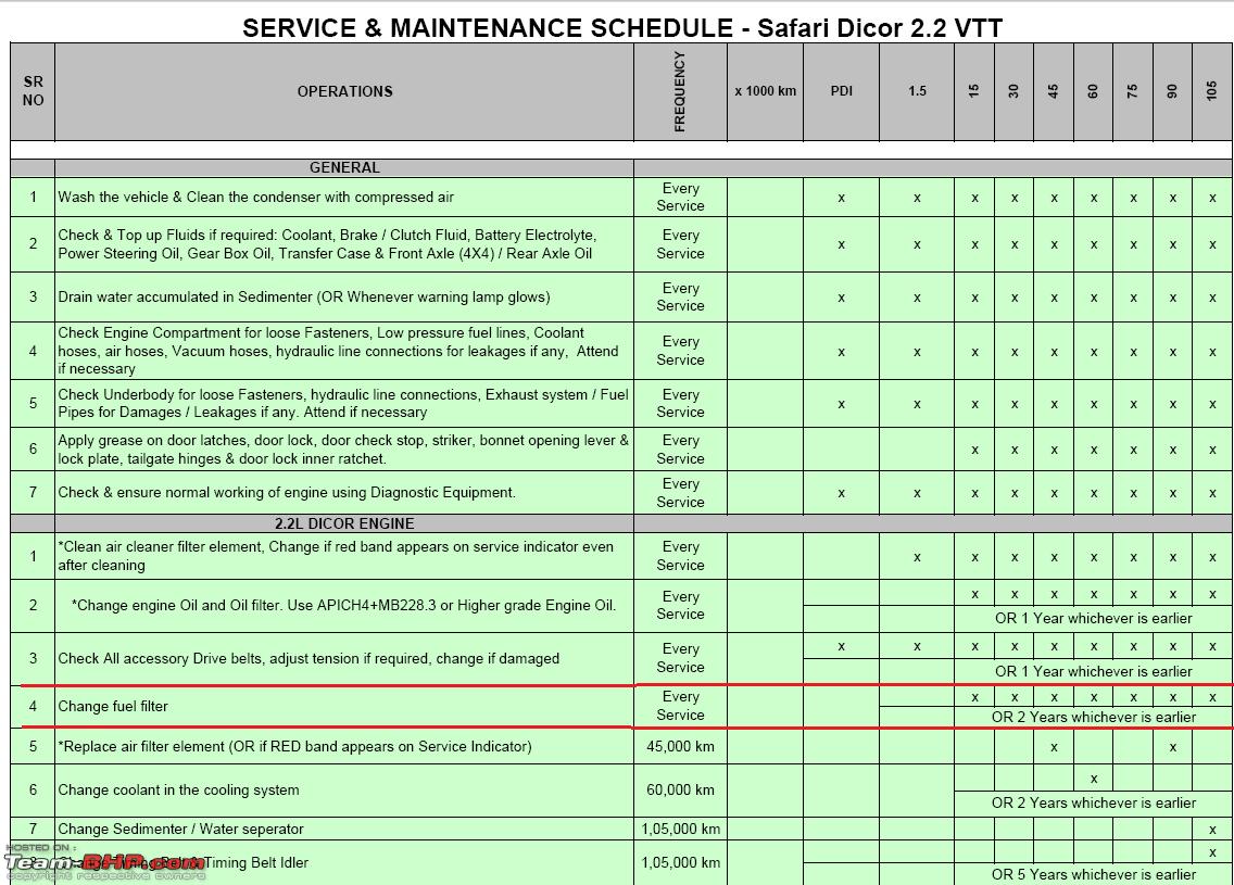

Hi Experts,
What is the recommended interval for Fuel Filter change? My safari went for 3rd free service (15,000 kms or one year) yesterday at Concorde Motors, Mathura Road, Delhi. It has run only for 9,000 kms in the last one year.
The service adviser replaced it even after me showing him the service booklet which recommends interval as 30,000 or 2 years (Point no. 4 at page 145). It has costed my more than Rs. 1600. He did show me some communication (refer to picture below) from TATA motors dated back to 4th Oct 2007 and charged me the amount. This document shows "Every Service" under frequency and he didn't bother for the current kms (9k) covered. So now I have new fuel filter at 9,000 kms.
Please advise if this is fine or I've been taken for a ride by Concorde (like other TASS) too?
By the way, he was forcing me to get the air filter replaced too without looking in to the actual condition (red band on service indicator) of the existing air filter. He didn't force me when I asked him to open up the bonnet and check in front of me. He was showing my "Every Service" under frequency of service schedule but I insisted upon just cleaning it with air pressure.
I hope that I saved Rs 600 but lost Rs 1600 in my 3rd free service of Rs. 4,993.
Here is the detail breakup (INR):
  • Engine Oil: 2,005
  • Assy. Oil Filter: 204
  • Assy Fuel Filter: 1539
  • Front & Rear Axle oil: 508
  • Fevi Quick: 12 (to paste the central roof light cover, which fell off while driving)
Please note that the above amounts are after getting 5% discount on total, which I could manage somehow.
The problem which could not be rectified: Left side window glass vibrates and makes a lot of noise when opened (10% - 90% of window), while driving at any speeds.
Resolution Provided: It will remain like this only as this is by default in a Safari and I have to drive with a fully opened or a fully closed window glass, which I currently do.
Cheers!
Irish

Originally Posted by Irish View Post
Hi Experts,
Fuel filter change is recommended at every service, as per their new directions which came out 2 years back, if I remember correctly.
Air filter change should be done after looking into the condition of the Air filter, if the running is not much and not in too much dusty conditions, should be fine every 2 years.
